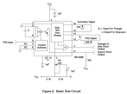

The XR2206 works just fine off a single supply without any kind of rail splitting, you just need to read the datasheet. Figure 2 shows a single supply example.
XR2206 single supply
If you go this route, be mindful of the minimum single supply voltage.
DC Electrical Characteristics
Also, a word of caution: the XR2206 is several years obsolete. Do not use it for anything that you may want to put into production.
