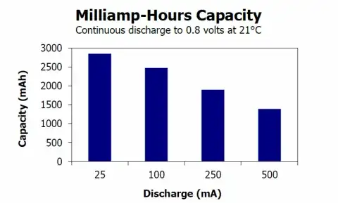

Consider the datasheet for Energizer AA cells. A chart is provided which shows you the various milliamp-hour capacities at various loads:
AA Battery mAh Depletion Chart
If you continually power a device with 25 mA, the cell will have approximately 2750 mAh. If you divide this current into the capacity, 2750/25, you get the number of hours that the battery can sustain it: 110. If the load is 500mA, the cell's usable capacity actually drops to approximately 1500 mAh, and 1500/500 is only 3 hours.

    "Even though milliamp-hours is often treated like a finite amount of energy" suggests that maybe \$mAh\$ is a unit of energy, but it's not. Also, at higher rates of discharge, you *do* get the full capacity, but you get it at a lower voltage. Note that the graph says "discharge *to 0.8 volts*". – Phil Frost Aug 17 '13 at 10:53
  • I should probably change "energy" to "charge" for accuracy. I'm not sure I understand/agree that the full mAh charge is available at higher discharge rates. The cell discharges and its voltage lowers at any discharge rate, but it's a matter of how soon that occurs. Isn't it true that a higher discharge rate decreases the *efficiency* of the cell and therefore total mAh capacity is reduced? – JYelton Aug 17 '13 at 10:59
  • Not really. There is so much charge separation in the battery, defined by the chemicals in it and the quantity of those chemicals, and the charge can't go anywhere else. At a higher discharge rate, the voltage at the terminals decreases, and can drive the charges less quickly, but they are still separated. You just might have to wait longer for them to un-separate, and you will have less voltage available at the terminals, and thus less electrical energy. – Phil Frost Aug 17 '13 at 11:01
