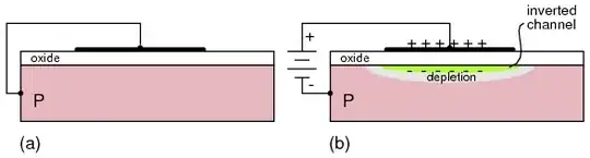

The answer is at the end, but, just in case you are not familiar with the concept of MOS capacitor, I'll do a quick review.
MOS Capacitor:
The Gate of MOSFET transistor is essentially a capacitor. When you apply any voltage to this capacitor, it responds by accumulating an electrical charge:
The charge accumulated on the Gate electrode is useless, but the charge under the electrode forms a conductive channel which allows for a current to flow between Source and Drain terminals:
The transistor switches ON when the charge stored in this capacitor becomes appreciable. The Gate voltage at which this happens is called the Threshold Voltage (essentially it is the Gate-to-Body voltage which is relevant here, but let us assume that the Body is defined as zero potential).

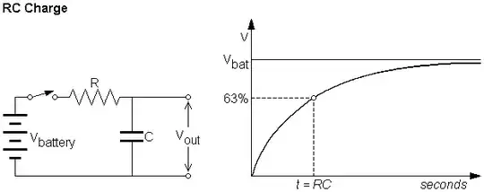

As you may know, charging a capacitor through resistor takes time (there is always some resistance present, even if the schematic does not contain resistors). This time depends on both capacitor's and resistor's value:
Combining all the above statements together we get:
  • Transistor's Gate is a capacitor which should be charged through a resistor in order for transistor to "switch ON"
  • The higher the input capacitance of the Gate, the longer it takes to switch the transistor ON
  • The higher the resistance between the voltage source and the Gate, the longer it takes to switch the transistor ON
  • The higher the externally applied voltage, the shorter it takes to switch the transistor ON.

    I think the 2nd image is a bit confusing, because in most MOSFETS [the source and body are connected](http://electronics.stackexchange.com/questions/72582/mosfet-why-the-drain-and-source-are-different). Yet, the image shows opposite charges at the source and body. It demonstrates the capacitance point well, but maybe isn't realistic. – Phil Frost Aug 16 '13 at 11:44
