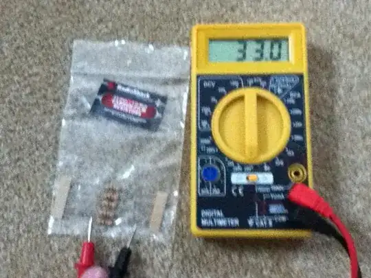

Edit: I have some pictures:
Multimeter showing 33.0 OHMS That is my reading on a 33 OHM resistor. I don't think my multimeter's battery is good still. I'm going to replace it. :P

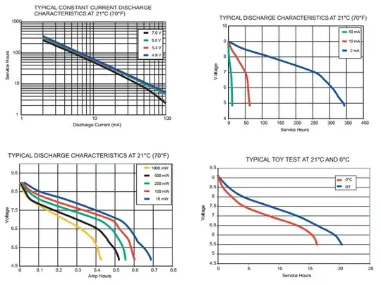

If you do open it, and the meter is still working okay, you can use it to test it's own battery voltage and get a reasonable indication of battery health under a small load. Check reading against a battery graph of the same type.

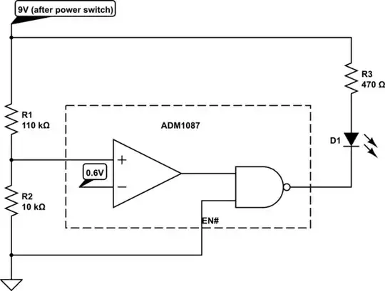

There are several solutions presented here which seem to be going about it the hard way.
An Analog Devices' ADM1085 is a small supervisory IC. It costs $1 in onesie-twosies from Digikey. There are variants that give active-high or active-low outputs, and the outputs are open-collector. Basically the output will assert when the input voltage falls below the 0.6V reference.
Let's assume you have a meter that uses a 9V battery and starts acting funny at 7V, so you want the low battery indication at maybe 7.25V. The IC will assert its output when the input voltage is less than the on-chip 0.6V reference, so we want a resistor divider that will present about 0.6V to the input when 7.25V is presented across the divider.
A divider using a 10k and 110k resistor gives the appropriate ratio: 7.25 * 10k/(10k + 110k) = 0.604V. This will draw 70uA with a fresh 9V battery when the meter is on which would be considered insignificant.
Now you want to light an LED when the battery is low. Ignoring that this will load the battery and possibly drop the voltage lower, you will have 7.25V when the indicator turns on. Let's give ourselves some margin in selecting the current limit resistor for the LED since we want to make sure the LED will be visible. Let's also assume that 10mA will give you the visible equivalent of a klaxon.
Assume a 2V LED drop for a red LED, 1V drop across the open-collector output transistor. 7.25 - 2 - 1 = 4V across the resistor. R=V/I, so R=4V/10mA or 400 ohms, so select 330 or 470 ohms as the closest E24 value. If you use a high efficiency LED you can get away with less current.
The schematic now starts to take shape:
Now a SOT-363 might not be the easiest package to work with. Digikey has alternative products in easier (but still surface mount) packages. You can always use an adapter board like this; Sparkfun has a wide selection of them.
So there you have it, a five component low battery indicator that doesn't drain the battery, doesn't cost much and is something you could build in an hour or so. You could conceivably replace the supervisory IC with a comparator and zener diode but I think this might load the battery less.
