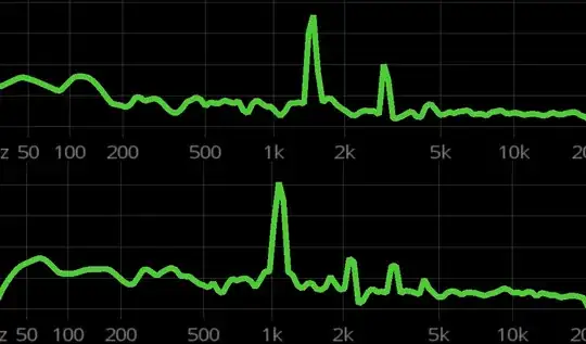

The receiver is based on the TDA7000 (yes I know that's obsolete) with a fixed tuning frequency. Here is the received spectrum for two different case, the peak at 1.1 KHz should indicate logic LOW and the peak at 1.6 KHz should indicate HIGH, the peaks are about 300mV, but I guess it may vary
received spectrum
Note that there are distrotions at 2.1 Khz and and 3 Khz.
How can I feed the signal to an FPGA, which should count and identify the frequency, with a minimal number of parts, I guess LM741 is too much for that kind of task. How do I deal with the distortions? Any other suggestions?

The top trace looks like 1.6kHz (high) and the bottom trace looks like 1.1kHz (low). What equipment are you using for getting these spectrum traces? Also, where on the TDA7000 are you measuring? Also what carrier frequency are you using?
The top trace also shows a peak at about 3kHz and don't be surprised by this because your modulation method stinks and it will produce harmonics of the modulator frequency and the carrier frequency.
I'd say the distortion you are seeing on the top trace is at 3.2kHz and on the lower trace I'd say you are seeing 2.2kHz and 3.3kHz.
I'm not that certain because we don't know anything about the display with the green traces on?
  • I've connected the output of the TDA7000 to speakers and get the spectrum with an Android app which plots the the spectrum from the microphone.The carrier frequency is 105.33Mhz – Kirill Kulakov Aug 10 '13 at 16:01
  • What's the android app called - there is a good one called FrequenSee. I use it for on the spot audio checks. How did you extract the screen data by the way? – Andy aka Aug 10 '13 at 16:58
  • Yes, that it, I'm using this one as well. I took a screen shoot, try holding two physical keys togather – Kirill Kulakov Aug 10 '13 at 17:10
    @KirillKulakov I must be going blind!!! – Andy aka Aug 10 '13 at 17:21
  • any suggestion about the decoding circuit? – Kirill Kulakov Aug 10 '13 at 17:33
  • @KirillKulakov I'd be tempted with decoding by using a quadrature FM detector. Or maybe look at pin 6 of the TDA7000. This pin fed into an AM detector might work. If you are using the TDA7000 to its best and transmitting data continuously, the LC tank should be kept dead centred on your carrier and as modulation pushes it one way or the other you might get reduced amplitudes for 1's and 0's. Alternatively use band-pass filters at audio and AM detect each BPF. I'm no expert on the chip by the way. – Andy aka Aug 10 '13 at 18:08
