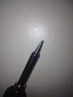

I purchased this 25W soldering iron a few days ago and used it for the first time without any problems. A few days later I tried using the iron again and the solder would not "stick" to the tip when I attempted to tin it.
I read up on this subject and thought that the tip might be dirty. So, I went about cleaning it. I tried to use a wet sponge when the iron was hot. This worked nicely, and the iron looked great! However, the solder still would not stick. So I then tried using a brillo-type pad to clean it. Yet again, the iron came out looking great but nothing would stick to it.
Here is an image of the clean iron:
I am not sure what to do. Any suggestions?

  • Clean tips always have an oxide layer which prevents solder-wetting. "Rosin flux" is used to dissolve that layer. Common solders provide a flux core which does the job. So, might you be using solid, non-flux solder? – wbeaty Jul 24 '17 at 07:30

Some tip tinner/cleaner compound will reduce the layer of non-metal/oxide that has accumulated on the tip and is preventing the solder from sticking. With a 25W iron you'll probably need one with lead in it.
Also, be careful when abrading the tip since solder will erode the copper underneath if the non-copper layer is removed completely.

  • The picture I provided looks exactly like the day I purchased the gun. There is nothing on the tip and it looks very clean. I wanted to avoid actual 'tinner' substances because I know they are extremely bad for you if accidentally inhaled. Thanks for the answer. – sherrellbc Aug 05 '13 at 01:42
  • I recommend using a desktop fume extractor when soldering regardless. – Ignacio Vazquez-Abrams Aug 05 '13 at 01:44
  • Also, oxide layers are almost invisible when only a few atoms thick, but they will still repel solder. – Ignacio Vazquez-Abrams Aug 05 '13 at 01:45
