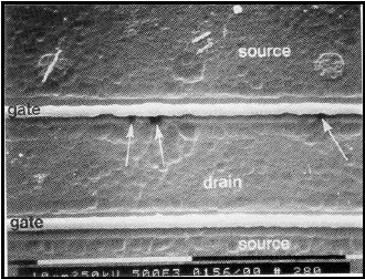

A diode fails closed due to overvoltage. This is called punch-through. This is is the principle used in ESD diodes. If they can't handle the voltage the PN juntion fails and short to ground, protecting any circuitry after them. On the image you see a small black dot where the voltage went through the junction. eg:
*Second picture added that shows this better on a MOSFET.
A diode typically fails open due to over-current. This is called metallization burnout and can occur from things like EOS (Electrical Over Stress). Image shown bellow. Over current causes excessive heating and literally burns the metal away. As mentioned above this is easy to demonstrate on LEDs as their current carrying capability is much lower than rectifier didoes.

  • +1 I can't make much of the first picture, but the second one looks "open" indeed ;) – Rev Aug 02 '13 at 06:31
  • Added a better image of the same problem but on a BJT, not a diode. – EasyOhm Aug 02 '13 at 06:37
  • So the junction is already permanently damaged where the black dots are? It looks intact. – Rev Aug 02 '13 at 07:01
  • Where the black dot's are the gate and drain are shorted together - while the rest looks intact current will flow through the short instead. – EasyOhm Aug 02 '13 at 07:18
  • The second picture is not BJT, but MOSFET. Good answer +1 – Vasiliy Aug 02 '13 at 08:40
  • The text where I got the image claimed it as a BJT. I realize the naming convention of gate, source and drain is usually reserved for FETs. The reader should take the second image with a grain of salt as I can't confirm what type of transistor it was. – EasyOhm Aug 05 '13 at 05:52
