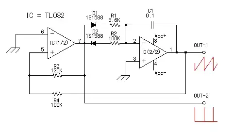

My query is: Is there a cheap, easy for implementation solution, which could generate sawtooth/ramp waveforms (triangle as an extra is welcome too) with linear slope (without aliasing or discretization artifacts), adjustable frequency and fixed amplitude in wide frequency range?
The key part of this query is "without aliasing or discretization artifacts" because this points to using an analogue circuit like this: -
I said "like this" because I'm fully aware that the TL082 isn't butch enough to keep a good ramp shape at 2MHz but there are plenty of op-amps that can.
But what about the title of the question - it implies the saw should be derived from a clock source (sine or square) and I'd like to point out that the output (at pin 7) shown above could indeed be the clock source.
Does the OP actually mean a clock source of his own production such as from an IO pin of an MCU? If the answer is "yes" then you may well be facing using a PLL and counter BUT using this method means you will have discretization artifacts and won't give you the required 1Hz to 2MHz range.
