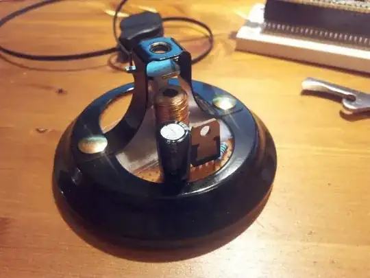

I need to wind a small electromagnet "solenoid?". About 3cm high and 2~5cm wide running at 5V/0.5A. This magnet will be put into a desk bell so it pulls the clapper down and rings the bell. I have found ready made solenoids that push out but not pull.
So I am attempting to make my own magnet and I have wound several different types of screws, nails and bolts with different types of wire. And now I have noticed a problem with precision :) I can wind a massive coil and it will work but how do I wind a small yet powerful coil?
I can't really find a laymans explanation on what diameter core cable to use and how many windings. In general the more windings the stronger the field which is common across all articles I read.
I found an article where somebody says that the windings should be wound in the same direction (clockwise layer, clockwise layer...etc) to create a truly stronger solenoid but all articles say just wind them back and forth (magnet?)
Can somebody in general suggest what kind of core material and diameter would be the best and if winding the coils in the same direction will actually help. Also is there any difference which way the ends are pointing or do both sides emit the same field?
At the moment I have PCB with 3 1000uf caps in parallel to the coil that is triggered by a transistor. I will be using aTiny that triggers the transistor maybe 0.2seconds and I need a jolt of magnetic power to pull the clapper down and release instantly.
-EDIT
This is a project that somebody got working using USB power and winding his own coil. He uses a darlington transistor? Does that influence the coil somehow? I only have a normal transistor. The gap there has to be about 1.5~2cm so the clapper can smack the bell. I have the same bell. He reckons he used 2m of cable to wind the coil... I used 3.5metres and wound it much much neater than his..

I ended up using a 5v solenoid. Removed 2 capacitors and used the pushing end of the solenoid to kick the clapper out. And DING! It works like a charm. I have no idea how the guy made that electromagnet pull down the clapper?!

  • http://www.youtube.com/watch?v=XJde2GzcAyo&feature=youtu.be That is my solution. I realise the 1000uf cap is a problem and needs to be changed to a 470uf. It will still work with the 5v pretty well. I think that instructable is bogus! There is no way that hand wound coil can pull that clapper down! – Piotr Kula Aug 07 '13 at 15:54

  • I redid my coil last night, very neatly and close together. about 3 metres of enameled wire. The electromagnet is stronger (I wound the coils all in the same direction ...) but it doesn't have the power to pull the clapper from a gap larger than 0.5cm. I need at least 2cm gap. I am giving up on this :( – Piotr Kula Aug 01 '13 at 08:15

  • @ppumkin 2cm is a big gap dude - any chance of a little picture with dimensions on and estimated number of turns and current thru coil. – Andy aka Aug 01 '13 at 11:04
  • I edited my question and added a project that works. I am trying to follow that but it just seems impossible?! – Piotr Kula Aug 01 '13 at 11:37
  • I ended up using a premade 5v solenoid that pushes the clapper.Removed all caps and it works great. Too bad I couldn't get the electromagnet to work :( – Piotr Kula Aug 02 '13 at 08:17
