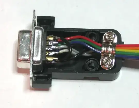

Similarly, but less often seen now in the days of cheap molding or diy kits, is this. The cable is screwed into a holder which is prevented from moving in OR out by the case and screw posts. enter image description here

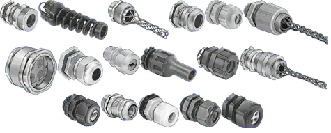

The third is through the use of Cord Grips or Cable Glands, also known as grommets. Especially is a water tight fit is needed.
They are screwed on, the cable past through, then the grip part is screwed. These prevent the cable from moving in or out, as well as sealing the hole. Most can accommodate cables at least 80% of the size of the opening. Any smaller and they basically won't do the job.
Other options include cable fasteners or holders. These go around the cable and are screwed or bolted down (or use plastic press fits). These can be screwed into a pcb for example.
Cable grommets are a fairly hacky way of doing it, as they are not designed to hold onto the cable. Instead they are designed to prevent the cable from being cut or damaged on a sharp or thin edge. But they can do in a pinch. As can tying a knot, though that mainly prevents pull outs, but might not be ideal for digital signals. Pushing a cable in doesn't happen too often, so you might not worry about that.

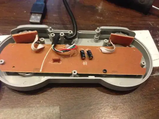

Similar to the second method, is using two or three holes in a pcb to push a cable through (up, down, up), then pulling it tight. This moves the point of pressure away from the solder point and onto the cable+jacket. enter image description here

"Strain relief" or "cord grip" is the magic phrase for Google you are seeking. Here's a selection from McMaster-Carr:
strain relief fittings
Cheaper devices might use gobs of glue or knots in the cord, in combination with a simple grommet, depending on the anticipated stress, cost, safety, and regulatory requirements.

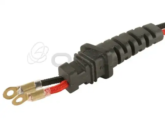

You want a cable bushing like this:
The bushing wraps around the cable and goes into a hole of a certain size. The hole is slightly undersize for the bushing and cable combination together, which forces the bushing into the cable and forces the bushing into the hole so that it won't slide out.
Many consumer devices use this bushing for power cord entry. But it is available for cables of other sizes as well.
The one pictured is Digi-Key part RP465-ND.
