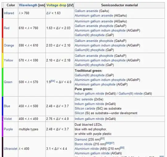

It's a valid approach just for general cases simply because most LEDs happen to have a forward voltage drop near that value.
Here is a table take from wikipedia on the voltage-drop of different LEDs:
Voltage drop
You can see that for some reds, oranges, yellows, and some greens, 2V is close to the value. I suppose if you were making a circuit with ultraviolet LEDs you could assume 3.5, or 4V. Now if you actually know the forward voltage drop on the LEDs you are using, it would make a lot more sense to use that value.

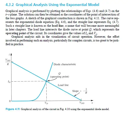

Going off of what echad said, the constant voltage drop model is the simplest one, and speeds up analysis. In reality, voltage drop on diodes have an exponential relationship.
Also, there are several different models for analyzing circuits that contain diodes.
Taken from a textbook I use at school, Microelectronic Circuits 6th Ed, by Sedra and Smith:
Graphical Analysis of the Exponential Model, using a load line

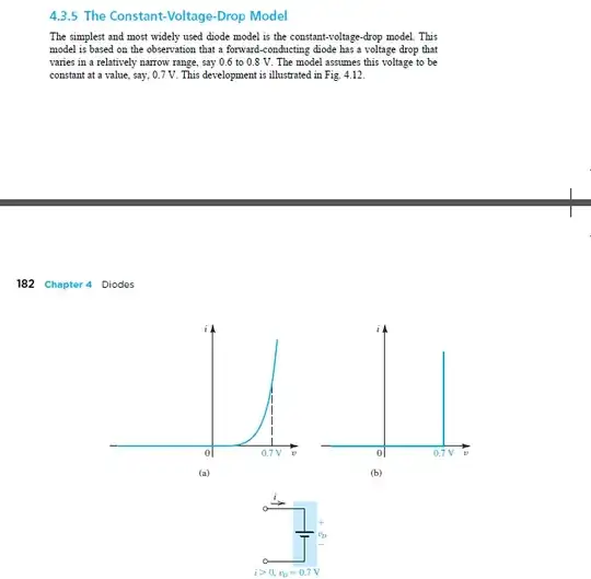

There are several ways to model the diode forward characterstics, one of the simplest forms is the Constant Voltage Drop Model
Other than that, there's also
  • The Exponential Model
  • Piecewise-Linear Model
What makes the constant-voltage-drop model useful is it allows speeding up the analysis of circuits. However you are exchanging quality for time. The exponential model gets you the most accurate answer out of the these three models.
