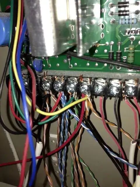

I've got a messy security panel that needs cleaning up badly, as I need to connect another PCB for remote access and can't get the wires to reliably stay in place:
If you look at the black, red, green, and yellow terminals, they already have three separate wire (pairs) connected!

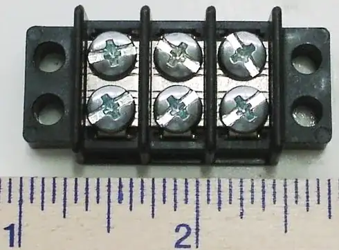

So far, a terminal strip like this is the only solution I can come up with. However, I'd have to add an additional bus bar across the terminals that need to share a signal, which just adds to the size of the bar needed and is a little inconvenient:

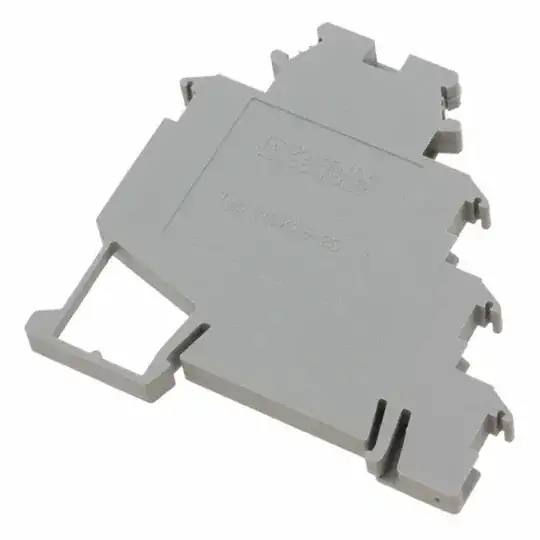

There's always Phoenix Contact terminal blocks like the following:
However, at over $10 each from Digikey, it's a pretty expensive (though elegant looking) solution.

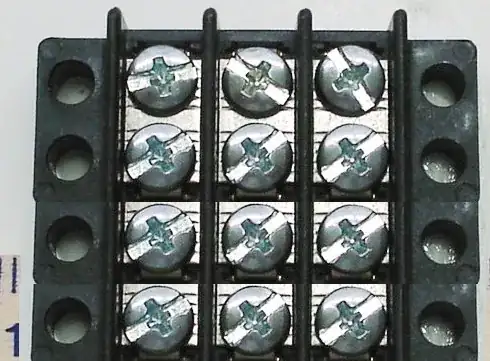

I guess I'm looking for something like the following photochopped image?
Note that I'd like a bus bar that connects the columns of terminals...

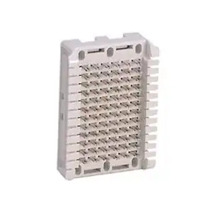

A Punchdown block would do nicely.
None of those wires seem high gauged, and some look like they were puled out of cat 5 anyway.
Other names for these are 110 Blocks, 66 Blocks, M-Blocks. They are used for telephone, voice (Cat 3) and data (cat 5/6) wiring. Also used in alarm system wiring.

  • Ah, I like that! – Dave Jul 29 '13 at 18:44
  • got a direct link? I am fighting with digikey's website on this one... – Dave Jul 29 '13 at 19:18
  • No direct link, but you can get these retail at like Lowes or Home Depot in the cable/tv/phone section, or any telcom or video equipment store. Hell, you could flag down a verizon truck and ask them, they install them in homes for wiring. That specific one I found via google image search, can't vet the store http://www.frostelectric.com/index.jsp?path=product&part=299751&ds=dept&process=search&qdx=0&ID=,Voice...Data,Patch.Panels...Accessories – Passerby Jul 29 '13 at 20:47
  • @Dave and avoid the ones marked "split block" or that come with "bridging clips". Those arn't connected in the middle. Most new ones don't use bridging clips, the entire row is connected across. – Passerby Jul 29 '13 at 20:50
  • Thanks! I'll definitely hit up a store or the local electronics shop. – Dave Jul 30 '13 at 01:31
  • Well, Home Depot and Radio Shack were a bust. But once I found that these blocks are also called "66 Blocks", I checked Amazon again and found the exact one you posted an image of! And I got the last one! Can't wait to get this and see how it works. :) – Dave Jul 31 '13 at 13:25
  • Oh, it also looks like you edited your post and actually included the other names for the block. Thanks! – Dave Jul 31 '13 at 13:25
  • @dave yea, I wanted to be complete on the information. Mind posting a link to the amazon page? – Passerby Jul 31 '13 at 13:27
  • Here it is: http://www.amazon.com/Hubbell-BLOCK-MODULAR-66B-6PR/dp/B002FYCCTG/ref=sr_1_6?ie=UTF8&qid=1375278112&sr=8-6&keywords=66+block. Note that people who have purchased it also bought bridging clips... so I don't know if this particular model bridges already or not, but I'll update this question once I receive the block. – Dave Jul 31 '13 at 13:42
  • @Dave the also bought list also has a Split M 4 x 50 Block. The Split blocks require the bridging clips. The 6x12 block you got should not. – Passerby Jul 31 '13 at 13:54
This terminal block from Phoenix is only $1.07 under 10 CNT. You could get a few of these and a section of DIN rail.
http://www.digikey.com/product-detail/en/3044076/277-2026-ND/2051190 PDF for 3044076 Series
It can also take from 26AWG to 12AWG. Most of your wires look to be 26AWG (or similar).
Dont forget the jumpers to jump the blocks together that you want to match. Example Terminal Block Jumper
I am also a fan of Ferrules but they are definitely not required in a stationary one insert application.
The following is a link to a Ferrule Kit. There are many less expensive ones, this is just one i found quickly on digi.
Example Ferrule Kit
