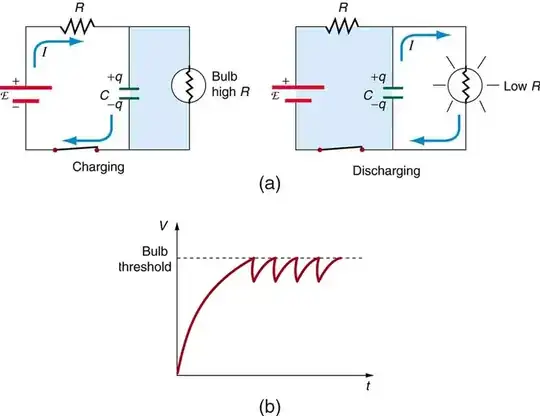

Capacitors behaving as an open circuits, How can we understand the concept of the Electrons flowing through a capacitors.
Current Displacement Through a Capacitor circuits

See EEVblog #486 – Does Current Flow Through A Capacitor?
Electrons do not leap from one capacitor plate to the other but whilst the capacitor is charging or discharging as many electrons leave one terminal as arrive at the other, they are not the same electrons but for all practical purposes you can say that changing currents flow through a capacitor.

    Good Link to the video, In a practical way current does flow through the Capacitor, the Changing current as you mentioned, the whole concept of Electronics is based on the displacement of electrons, through diverse electronics components forming an Electronics circuit or Network. A capacitor looking more like an open circuit, can`t be compare with a switch that can`t pass anything when open. – Chad Jul 26 '13 at 08:55
