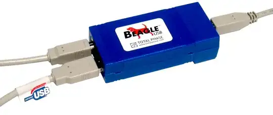

Since you can't modify the printer or the pc, a networked printer setup is out of the question. So you need a USB Protocol Analyzer. Those are a few hundred dollars a piece. Enjoy.

For a specific known device, you do not necessarily need a generic test instrument - you could, with sufficient knowledge of it's operation, use a microcontroller with both USB host and device ports to man-in-the-middle the traffic by pretending to be each end to the other and passing traffic between the two emulations.
That drops the unit cost to the $20-30 range, but likely increases the software development cost substantially... It also changes the failure mode from "failure to capture" to "failure to print"
