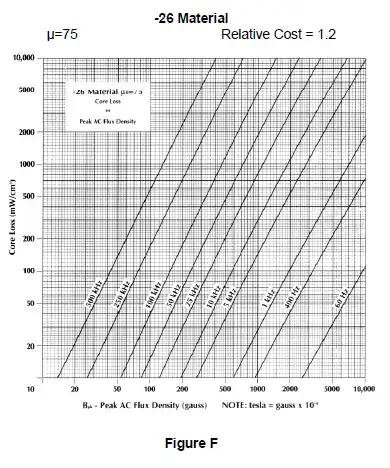

Here's a chart, which illustrates how core losses behave. The chart comes from an application note by Micrometals (a manufacturer of powder iron core materials, which are used in inductors).
Notice that the core losses increase when:
  • switching frequency increases
  • peak magnetic flux density increases

  • I appreciate the answer, but it doesn't tell me WHY core losses increase when frequency and flux density increase. What's actually happening to translate that into thermal energy? – Stephen Collings Aug 19 '13 at 13:10
