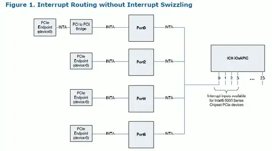

But wait, that's where the fun just begins. This level-triggered logic of INTA..INTD interrupts in PCI-e is system-wide. In a typical PC chipset + peripheral cards, you will have many sources of INTA..INTD interrupts. And, their level-triggered logic needs to be merged together. In physical wires, this is done in a "wired OR fashion", active low logic with open collectors and a pull-up. In PCI-e, the state of each INTx virtual wire has to be merged "virtually". And, the merging is handled in a cascaded fashion by the PCI-e bridges (switches). Every PCI-e bridge/switch contains four "memory cells" that merge the assert/deassert messages from downstream PCI-e ports into an internal state, and changes of that internal aggregate state are then signaled further upstream. So there's a cascade of PCI-e switches, letting the four INTx "level-triggered" states float up the bus tree, until it reaches the PCI-e root complex. The root hub, a key part of the chipset's north bridge, does the final stage of INTx level merging, and... and forwards that state to the IO APIC! Down the "hub link" port, away from the CPU! The IO-APIC (actually now re-branded IO(x)APIC) merges those four aggregate "virtual wires" with its potential four physical wires at inputs A..D, and... finally forwards the interrupt events to the CPU LAPIC. Up the "hub link", up the FSB. The principle remains the same in modern PC platforms where the north complex is integrated on the CPU die, or where the south part is now in the same SoC package too.
I've recently noticed another question about this at some StackExchange forum, cannot find it now... But it means that if you plug some peripherial into the broad PCI-e ports connecting straight to the CPU socket, and the peripherial runs with "legacy compatible" INTx interrupts, the interrupts have to go down the HubLink (now called DMI) to the IO-APIC in the South Bridge, and re-processed back up the HubLink and finally to the CPU. Even funnier, a peripherial attached to the South Bridge, if using legacy INTx compatible PCI-e interrupts, will theoretically result in the interrupt traveling up the hub-link to the root complex (final point of PCI-e INTx merging), down to the IO(x)APIC in the S.B. (final point of virtual and wired INTx merging), and again up the hub-link to the CPU :-D
I would hazard a guess that with peripherals integrated in the ICH (south), Intel "cheats" = optimizes by providing direct wired IRQ links to the IO(x)APIC, so that they don't have to travel up and down the HubLink. Not sure about external peripherials, attached via an external PCI-e/PCI bridge, talking to the south bridge over a PCI-e port (as modern ICH's/S.B.'s no longer have a physical parallel PCI port).
And, that's not where the fun ends. As most PCI-e devices in legacy INTx mode will default to the local INTA "virtual wire output", and the same holds true for many physical PCI devices connected by PCI-e/PCI bridges, the legacy OS would end up sharing the IO(x)APIC's INTA input among all the peripherals in the system. All devices sharing IRQ16 - can you imagine the havoc?
without swizzling

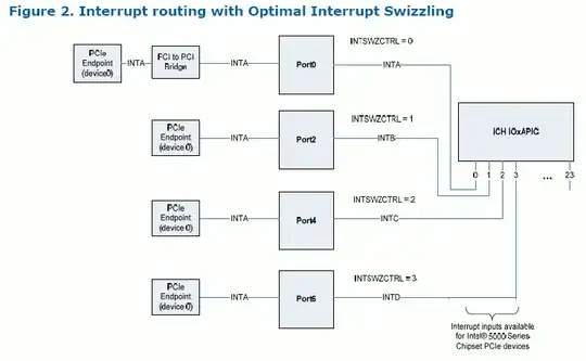

To address that problem, Intel has introduced "virtual wire INTx IRQ swizzling".
with swizzling
The two pictures are taken from an Intel appnote listed below in "references".
