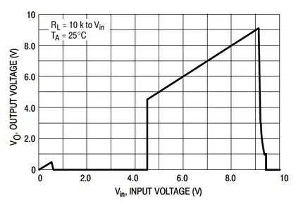

Look at what happens during power-up: Vcc rises to a point where it's high enough to make everything work properly. However, that point isn't clearly defined and may vary from device to device. It makes sense not to use this voltage to reset the controller.
It's easy, however, to keep a level low regardless of Vcc. After all, Reset is already active the instant you switch power on, since at that moment everything is at a low level.
edit
The graph below illustrates how the output voltage of the reset controller (i.c. an MC34064) remains low until Vcc is high enough to have the complete microcontroller stable.
alt text

  • This is what I was going to ask. – Kortuk Dec 08 '10 at 17:37
  • -1 -- It's just as easy to keep a level high regardless of Vcc. You use a pullup transistor or resistor, the same way you would use a pulldown transistor or resistor. Your argument says nothing special about the difference between the voltages at the power supply pins. On power-up, they move apart, and the valid logic levels are relative to the power supply voltage. – Jason S Jan 08 '11 at 15:56
    @Jason: it makes more sense to keep it at a level which is *always* clearly defined than rely on a level which is constantly changing. – stevenvh Jan 08 '11 at 16:06
    Vcc and Gnd are both changing relative to each other. It's just convention that we think of Gnd as "constant" when it's really the two relative to each other. Vcc is only changing relative to Gnd because we think of it that way, rather than Gnd increasing negatively relative to Vcc. – Jason S Jan 09 '11 at 03:16
