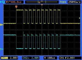

Looking at a waveform from a DMX lighting controller for example, I connected the channel 1 probe to D+, channel 2 probe to D-, and both ground leads to ground.
It produces this display:
Differential Signal Measurement
While this is usable, I know it's still not the correct way to look at differential signals.
What is the correct way? I've heard of "differential probes;" does that mean I need to purchase new probes?

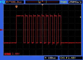

The reason you can't measure differential signals quite as easily with an oscilloscope has to do with the fact that oscilloscopes are (generally) not floating. The ground lead on the probes are connected to the oscilloscope chassis, which in turn is earth grounded. Because of this, anything you connect the ground lead to will also be connected to earth ground. (As videos I link below demonstrate, this is dangerous if measuring high voltage!)
When you measure two random points with a multimeter, the meter is floating, so you're not connecting either point to actual earth ground, which lets you measure differences between points without concern that you're creating a short circuit.
In low voltage signal applications, tying one side of a differential signal to ground can cause problems and might damage a transceiver.
There are two ways to measure differential signals with an oscilloscope:
If you have a two-channel oscilloscope, connect one side of the signal to channel 1, and the complementary signal to channel 2. The ground leads stay unconnected.
Since you are interested in the difference between the signals, you want to subtract channel 2 from channel 1. Most scopes provide a way to add or subtract channel 1 and channel 2 inputs. On some scopes you might have to add channel 2, but invert it so that you are effectively subtracting it.
In this image, the scope has an A-B mode which subtracts channel 2 from 1:
Differential Measurement Subtracting Second Channel
The other way is indeed using differential probes, and provides better results without reducing the number of usable channels on the oscilloscope. (And are usually designed for safer high-voltage measurements.) However these probes are expensive.
W2AEW does a superb job explaining these concepts in his video on differential measurements using oscilloscopes. There's also a video by BTC Instrumentation which shows the channel subtraction method in more detail.

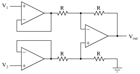

Other people have already explained how to configure your two oscilloscope channels to measure a difference between two signals.
Of course, you run into a problem if you want to measure some other signal besides that differential signal. I take it your scope has only two channels.
In such a case, you'd need a differential probe. But, as JYelton mentioned, differential probes are expensive.
However, as long as you're not trying to measure very high voltages or very high frequencies, you can simply make a differential amplifier circuit on a protoboard. You can power it from a battery or perhaps from the device you're measuring.
Differential Amp
Just make sure you use an op amp with adequate voltage swing, make sure it's stable, and you're good to use this simple circuit as a cheap differential probe.
