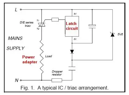

I think that it's worth considering the following idea. Using a triac to switch on and off your power adapter. For a start here is a document that gives the basic background idea and below is the "model" circuit: -
The real detail of the the above circuit is not included here; I've detailed an idea below but first consider what is happening above. There is a dropper resistor and capacitor in series which will always supply power to a zener diode. This is the main limitation of this design - there may be an inherent power draw from your AC supply of about 100mW. This is, of course, a lot less than the 2 or 3 watts your adapter burns when idle. You need to consider if this is OK for you.
The circuit needs to draw some residual power because the circuit needs to apply a continuous 10mA (or thereabouts) to the triac to switch it on and keep it on. I'd make an initial estimate that the dropper resistor and capacitor need to provide about 20mA to the zener.
This sounds a bit like 5W? Well, no because the capacitor will drop most of the voltage and the resistor is there to current limit to protect the zener from current surges. If the capacitor drops 220VAC at 20mA it has an impedance of 11,000 ohms (reactive). At 50Hz this equates to 290nF so maybe with a 220nF, the current taken will be 15mA and is mainly reactive power so doesn't get clocked by your electricity meter. Chances are this will be enough to power the latch and triac. The dropper resistor should be maybe 470 ohms restricting worst-case peak current from 230VAC to about 230 * 1.414 / 470 = 0.7A. It may work with a higher value resistor but I wouldn't go less than 470R and it needs to be adequately voltage rated for up to 250VAC.
The latcher: -
EDIT, I've shown a HC cmos chip but I don't think this will drive enough current to the triac so you'll need to find one that can drive 10mA possible a 74AC14 but please check.
This uses two inverters wired back-to-back to produce a basic latch circuit. The pushbutton when pressed will override whatever the latch output is and the capacitor will provide some debounce - it could be lower (say 10nF) if the switch is low on contact bounce.
REMEMBER, ONLY ATTEMPT THIS CIRCUIT IF YOU ARE CONFIDENT ABOUT WORKING WITH ELECTRONICS CONNECTED TO AC POWER - NOT FOR BEGINNERS.
