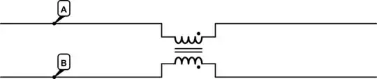

So schematically, a pair of wires passing through a ferrite looks like this:
Let's just look at half of this in isolation, just A. Any current in A will induce a magnetic field in the core, just like an ordinary inductor. Thus, you get an increasing impedance with increasing frequency, just as you would with any inductor.
The same is true of B, in isolation. But, if \$I_A = -I_B\$, that is, the currents are equal and opposite, the magnetic field induced by each current exactly cancels in the core. If there's no magnetic field, then there's no inductance, and so no added impedance.
Thus, this arrangement, called a common mode choke, presents a high impedance to common-mode currents, and a low impedance to differential-mode currents. The high impedance of the choke prevents significant common-mode currents from developing, and the ferrites for these applications are designed to be lossy, so common-mode voltages are mostly converted to heat in the core.

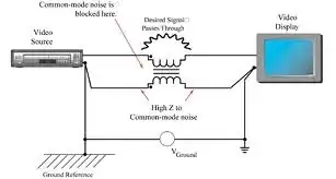

It's a common-mode inductor - one with a single turn. Differential signals are unaffected, common-mode signals are attenuated.
The ferrite material used in these things present a high impedance to high-frequency (MHz and up) common mode noise, which is why one usually sees them on DC power cables and on ribbon cables carrying relatively low frequency signals.
