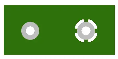

Just to show a visual on normal vs thermal relief pads:
Normal vs Thermal Relief PCB Pad
The pad at left is connected to the copper plane (green) in all directions whereas the pad at right has had copper etched away such that only four "traces" connect it to the plane.
