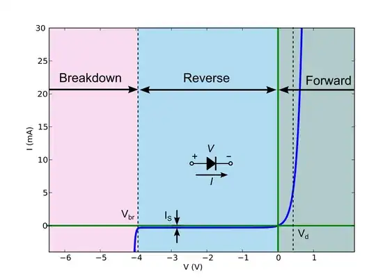

LED's aren't best modeled as a pure resistor. As noted in some other answers, real LED's do have resistance, but often that's not the primary concern when modeling a diode. An LED's current/voltage relationship graph:
diode
Now this behavior is quite difficult to calculate by hand (especially for complicated circuits), but there is a good "approximation" which splits the diode into 3 discrete modes of operation:
  • If the voltage across the diode is greater than Vd, the diode behaves like a constant voltage drop (i.e. it will allow whatever current through to maintain V = Vd).
  • If the voltage is less than Vd but greater than the breakdown voltage Vbr, the diode doesn't conduct.
  • If the reverse bias voltage is above the breakdown voltage Vbr, the diode again becomes conducting, and will allow whatever current through to maintain V = Vbr.
So let's suppose we have some circuit:
First, we're going to assume that VS > Vd. That means the voltage across R is VR = VS - Vd.
Using Ohm's law, we can tell that the current flowing through R (and thus D) is:
\begin{equation} I = \frac{V_R}{R} \end{equation}
Let's plug some numbers in. Say VS = 5V, R=2.2k, Vd=2V (a typical red LED).
\begin{equation} V_R = 5V - 2V = 3V\\ I = \frac{3V}{2.2k\Omega} = 1.36 mA \end{equation}
Ok, what if VS = 1V, R = 2.2k, and Vd = 2V?
This time, VS < Vd, and the diode doesn't conduct. There's no current flowing through R, so VR = 0V. That means VD = VS = 1V (here, VD is the actual voltage across D, where-as Vd is the saturation voltage drop of the diode).

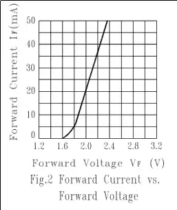

See, for example, this graph from the datasheet for LTL-307EE, which I picked for no reason other than it's the default diode in CircuitLab, and a pretty typical indicator LED:
forward current vs voltage
See how the line is essentially straight, and not vertical above 5mA? That's due to the LED's internal resistance. This is the sum of the resistance of the leads, the bond wires, and the silicon.

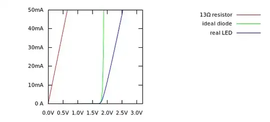

Here's such a graph with a resistor, an "ideal" diode according to the Schockley diode equation and no resistance, and a more realistic model of an LED that includes some resistance:
current-voltage graph
You can see that for values of current > 5 mA, the ideal diode looks like a vertical line. It's actually just very steep, but at this scale, looks vertical. But real LEDs don't do this, not even close. If you look at the slope of the line in the datasheet above, it looks like a straight line through (1.8 V, 5 mA) to (2.4 V, 50 mA). The slope of that line is:
$$ \frac {2.4\:\mathrm V - 1.8\:\mathrm V} {50\:\mathrm{mA}-5\:\mathrm{mA}} = \frac{0.6\:\mathrm V}{45\:\mathrm{mA}} = 13\:\Omega $$
Thus, the internal resistance of the LED is 13 Ω.
Of course, you must also include the forward voltage drop of the LED in your calculations, which is responsible for the shift to the right between the resistor and the real LED lines. But, others have already done a good job of explaining that.
At the end of the day, you only need to model those aspects of an LED that are significant to your application. 13 Ω of resistance isn't significant if you are going to add another 1000 Ω. The knee in the current-voltage curve isn't significant if the LED will only be on or off. But, in the interest of understanding what simplifying assumptions you are making, and when those simplifying assumptions are no longer valid, I wanted to explain: an LED does have resistance.
