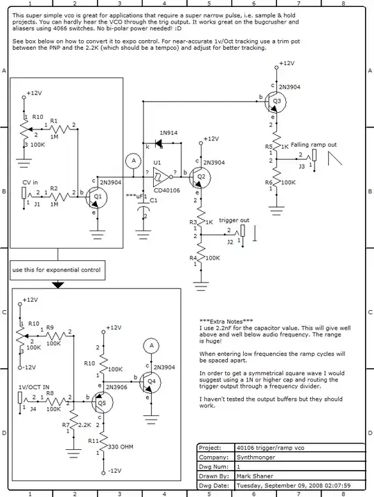

I need a simple exponential converter that with 9V and allows me to control a VCO. I've tried the one the schematics below but it needs bipolar power supply and just doesn't work. I have plenty of transistors and op amps, a simple circuit would be appreciated!

enter image description here Hello, I developed this exponential converter for my filter, but it's usable for other filters or oscillators, too. The resistors R3 and R6 limit the maximum output current. Feel free to use this expo-converter for your own device. It's a kind of poor men's converter.
Worth reading this paper: http://electronotes.netfirms.com/s019.pdf
The circuit in the picture works well in simulation.

There are a series of questions from JackDamery which relate to what you want - it's probably worth reading through these to get the jist of what worked for him. The problem is not the VCO of course but the log convertor.
At one point I suggested using a lower power dc-to-dc convertor to produce split rails so maybe this can be considered. Other than that it boils down to using digital methods i.e. reading a pot voltage into an ADC, converting to digital, applying a log function digitally and reproducing an analogue voltage output that is the log of the input voltage.
  • Thank you. Digital is the last thing I want. All I need is an antilog amplifier. – alkopop79 Jul 18 '13 at 12:44
  • @alkopop79 I gave you the option - either use a dc-to-dc convertor to get split rails or use digital. – Andy aka Jul 18 '13 at 14:50
  • How about JFETs? It seems to me that they have a more linear response as opposed to transistors. – alkopop79 Jul 18 '13 at 15:17
  • I've tried split rail and it didn't work. I've built the exact same circuit and it didn't work though I used 9V (-4.5V to 4.5V). – alkopop79 Jul 18 '13 at 15:20
  • @alkopop79 not enough voltage I think – Andy aka Jul 18 '13 at 17:17
  • I'm aware of that. How should I change the circuit then? – alkopop79 Jul 19 '13 at 04:10
  • I guess something like this would work: https://www.circuitlab.com/circuit/t2tezk/linear-to-exponential/ – alkopop79 Jul 19 '13 at 08:33
  • I'd go for a converter to give you +/-12V like this http://uk.farnell.com/tracopower/tmr-0522/converter-dc-dc-2w-12v-0-08a/dp/1242694 then you can decide how you want to implement the log-amp – Andy aka Jul 19 '13 at 10:23
  • Word for the wise - Those little brick DC-DC converters tend to be horrible noise sources, both common mode and differential. They may cause lots of other issues. There are flying capacitor voltage inverters that may be a much better option. They're certainly significantly cheaper. – Connor Wolf Aug 18 '13 at 09:26
