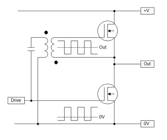

Here's a rough sketch of how you'd drive the source followers with just a drive transformer, although I think you'll need a power transformer and driver as well as just the drive transformer: -

    Could you elaborate on the transformer idea? I haven't heard of transformers driving a FET. FWIW, the parallel MOSFETs are for the full-bridge that I asked about a few days ago, which you answered. – Saad Jul 17 '13 at 20:51
  • For the top FETs, the drive to the gate, in order to keep the FET on has to be x volts above the source - as the source is also the load voltage, it makes the gate voltage drive non-trivial from the viewpoint of ground/0V. This means you need to raise the gate drive (relative to ground) to the same potential as the source and of course this is a little tricky so I'd "float" some power up to the top fet's source via a transformer so that the driver circuits were driving a gate voltage relative to the source (output voltage) BUT I need also to couple the gate signal up there too. Makes sense? – Andy aka Jul 17 '13 at 21:33
  • Hi @Saad yes, I remember!! This is going to be a tricky one but gut-feeling tells me it's going to work. Can you not find P channel FETs for the top transistors? – Andy aka Jul 17 '13 at 21:35

  • Andy, would it be possible for you to give me a rough schematic for this? Googling "Transformer Driving FET" doesn't return much. – Saad Jul 17 '13 at 22:24
  • @Saad you are missing my point - the top FETs are wired as source followers and this means the source voltage follows the gate voltage (no voltage amplification) and, if you want the top FETs to switch on efficiently your gate drive signal has to rise and fall relative to the source. – Andy aka Jul 18 '13 at 07:18

  • @PhilFrost it looks a good design. I was using the transformer conceptually to help the OP understand that you just can't activate the top FETs with a 0V based drive signal. – Andy aka Jul 18 '13 at 14:54
