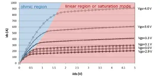

"Linear region" is unfortunately the most inconsistently used term when it comes to MOSFETs. It can mean exactly the opposite depending on the author. Compare:
Image from this appnote.
From this textbook, which calls the left region "linear region".
Also note that JEDEC has chosen "ohmic region" and respectively "saturation region" as their choice of standard terminology for MOSFETs (as in the 1st figure above). This is given in JESD77b on page "4-31". They avoided calling any region "linear".

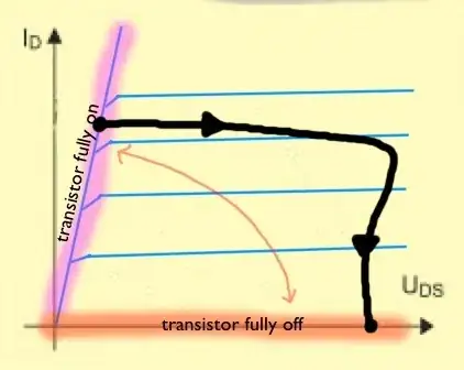

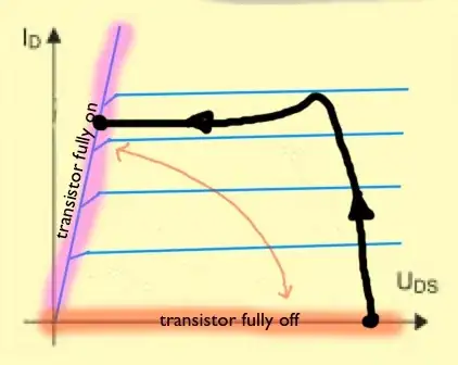

Linear region in this context means thee region where you don't want to operate in because the product Id·Vds is big therefore you have a lot of losses. You want to minimize the losses in transistor by having the transistor either fully on or off.
Switching between the two states should be as fast as possible because being there generates losses.
The area under the blue curve is the energy dissipated in the device. Switching slower makes the area bigger.
If you take a look at typical hard switching turn-on enter image description here
or turn-off

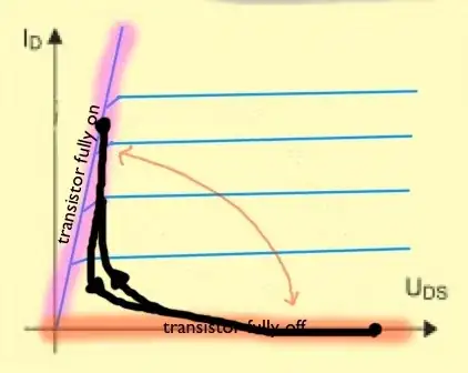

You can see that for some time there is high voltage and high current present on the device at the same time. Switching faster minimizes the time spent in that area.
There are ways to minimize the switching losses by using a zero-voltage or zero-current switching. You have to design your converter in such a way that it will switch only when either voltage or current on the transistor is close to zero. This way the power product of Id·Vds is also close to zero.

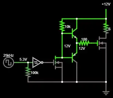

When using the MOSFET for PWM switching, make sure you are applying enough \$V_{GS}\$ so that the MOSFET's current limit is higher than the amount of current your fan/motor/etc. is going to draw. With Power MOSFETs, I recommend using the same voltage for \$V_{GS}\$ that you are using to power the fan/motor/etc. itself; this will ensure the fastest switching times, reducing the time you spend in the right region caused by charging/discharging the small capacitance of the MOSFET. Here is an example using an Op Amp to boost the PWM voltage:
Using Op Amp to boost PWM voltage
UPDATE: Here is another example using a totem pole to drive the MOSFET gate. This has an advantage of driving the gate with a high current.
Note: due to the second N-ch MOSFET, the PWM signal gets inverted, I changed the schmitt trigger to the inverting type to rectify this.
Using Totem Pole with boosted PWM voltage
Zista
  • High Rgate + opamp limited slewrate = more switching lost. – Long Pham Aug 22 '18 at 16:15
  • You would need to use an Op Amp suited to the switching frequency. You could also use other methods such as a totem pole, again components chosen will depend on switching frequency. – Zista Aug 22 '18 at 16:36
  • Long Pham is correct that Rgate could be smaller, its value depends on the max gate current specified in the datasheet. If you are using an IC to drive the gate (like the Op Amp example), the IC may have a lower output current limit that would be used instead to determine the smallest size for Rgate. – Zista Aug 22 '18 at 18:35
