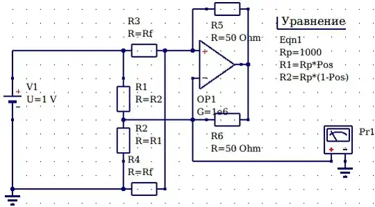

It is possible using negative impedance convertor (http://en.wikipedia.org/wiki/Negative_impedance_converter).
Connect its ground point to midpoint of a pot, and output to a wiper. If Rnic = -Rpot/2, then curve is nearly perfect.
Wpot
(Rf is -2*Rnic in this schema)
Vovanium
