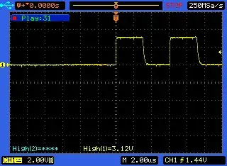

I am learning how to analyze SPI bus clock and data using an entry-level digital storage oscilloscope. I'm using a BK Precision 2542B to measure the output of the clock and MOSI lines from a Netduino that utilizes an ARM microcontroller.
Oscilloscope Image
In this image, I have the clock on channel 1 (yellow), and the MOSI on channel 2 (blue). The trigger is set to use channel 1, using a rising edge trigger of 1.44V. The clock square wave amplitude is about 3.3V.
The trigger indicator is at the center of the display horizontally, yet I have a pulse to its left. I was expecting the first pulse of the clock to start at the trigger location. I know that a digital storage oscilloscope allows you to see pre- and post-trigger events, but I'm confused why the first pulse isn't where I thought it would be.
Is my understanding of triggering incorrect, or am I just using a weird scope?

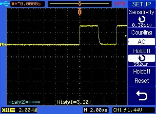

I discovered that a hold off time of 352μs will produce the expected result, but every now and then an extra pulse precedes the trigger.
Hold-off value

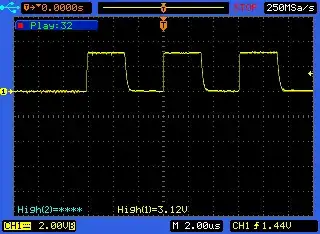

I recorded some frames to show the pulse both absent and present:
Leading pulse absent Leading pulse present

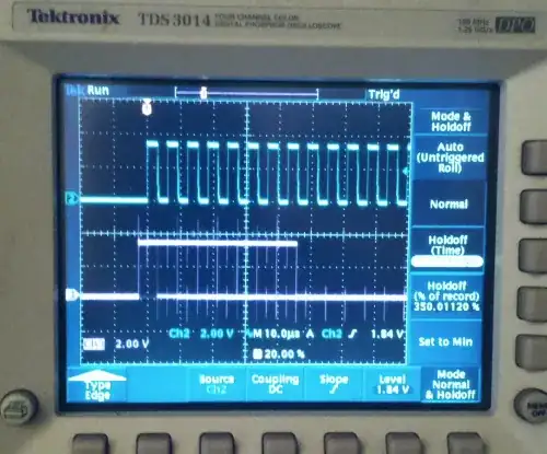

This same signal triggers just fine using a Tektronix TDS3014, with trigger hold off values ranging from 350μs to 1.5ms or more.
Tek TDS3014 Result
I think the answer, therefore, is to cross-check signals with more than one scope when something doesn't look right.
I was never able to get the BK 2542B to properly show the clock without either missing the first pulse, or showing random "glitching" or "garbage" making the clock pulses uncountable.
