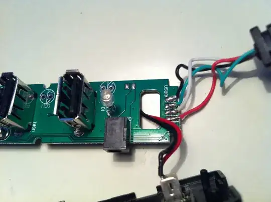

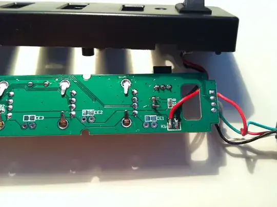

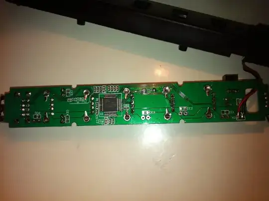

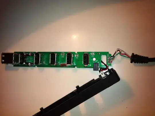

UPDATE
As per request in the comments, I'm adding few pictures here. And many more on this LINK (LogiLink 7 port USB HUB dismantled)
enter image description here enter image description here enter image description here enter image description here
Ivan Kovacevic
  • 305
    Can you open the enclosure of your hub and take a picture of the PCB? Properly designed hubs usually have (at least) a hub controller IC and power switch IC(s). It's also possible to cut corners in the design and leave out the power switches. Then it's more likely to back-power the PC. – Nick Alexeev Jul 12 '13 at 02:25
  • Is this a _powered_ USB hub? It shouldn't do this and it can cause weird problems on the PC side. – pjc50 Jul 12 '13 at 07:27
  • I will dismantle one now and take a picture. I also updated my question. Because I was not quite clear, when the PC is OFF(power cord disconnected) and hub is OFF(switch). The devices on the hub do not have power anymore(Although there is a measurable voltage on the usb hub ports still, around 2 volts, that discharges in the next 1 minute. I don't know if that is normal either). However the devices on the PCs other USB ports do have power, because of the backfeeding! – Ivan Kovacevic Jul 12 '13 at 07:28
  • yup it's a powered usb hub. The power adapter is declared as 5V/3.5A ... – Ivan Kovacevic Jul 12 '13 at 07:36
    Yeah, looks like the +5V line from your PC is directly connected to the +5V line of the hub's own PSU as long as the hub is switched on... – us2012 Jul 12 '13 at 11:53
  • I now tried cutting off the +5V line(red) so no power is connected to PC ... I thought that maybe the motherboard will then not recognize the hub. But it did! It's working fine as long as I keep its own power adapter connected. But is it OK to keep it running like that?! – Ivan Kovacevic Jul 12 '13 at 12:04
