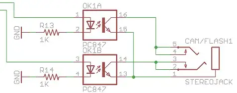

Nikon Hotshoe schematic
I measured a 5 to 8 volts signal between the trigger and the ground lugs when I push the shutter release. So my question is, if I wire the trigger lug to a digital input of the Arduino, where should I wire the ground lug to ? And subsequent question, do you think I should fear for my camera with the current/voltage involved?

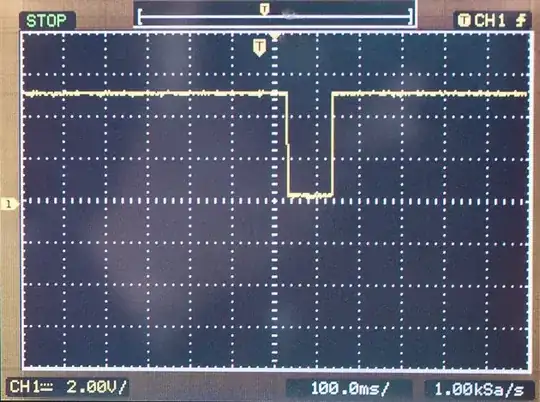

R2 could be omitted if you use the internal pull-up on the input line while the diodes just give a little extra protection against ESD and over-voltage situations rather than relying solely on the clamps within the AVR. Here's an example of the measured signal for a 1/10 second exposure using that circuit:
Flash hotshoe measured signal

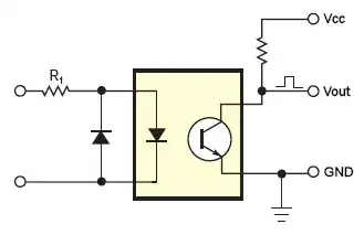

A simple optocoupler would be the best bet, to protect both sides. The led side would be connected to the trigger and ground of the hot-shoe, while the other side is connected to the arduino.
The Resistor on the arduino side is a weak pullup to the arduino power supply. You could skip it if you enable the internal pullup instead, in which case you do not wire the vcc/resistor part.
In this case, when the hotshoe is triggered, the optocoupler enables it's transistor, and the arduino would register a change from logic High, to logic Low.

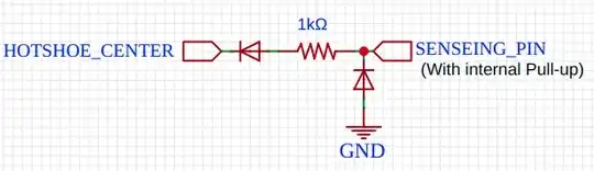

I've been using @PeterJ answer for a time-lapse camera controller, and it works perfectly. However, some applications (like mine), are battery-powered and require very low power on standby. If this is combined with a camera that is powered off during standby by a low-side switch, the circuit suggested by PeterJ leads to a current loss of about 0.1mA. This is because the camera works with 7.4 volts and the controller with 3.3V. And when the camera is powered off (by switching ground) the central contact of the hotshoe pin stays at 7.4V (at least that's the behaviour of an Olympus E-M5 camera). Leading to a current flowing through the diode clamp.
In this case, an alternative circuit would be something like this
It still protects from high voltages but stops any current flowing in such case. If anyone thinks this circuit has a weaknesses I'm not seeing compared to PeterJ suggestion, please comment.
