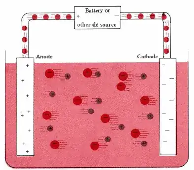

From the online GenChem Textbook section on Electrolysis:
Figure 1 An electrolytic cell. The battery pumps electrons away from the anode (making it positive) and into the cathode (making it negative). The positive anode attracts anions toward it, while the negative cathode attracts cations toward it. Electrical current is carried by electrons in the wire and electrodes, but it is carried by anions and cations moving in opposite directions in the cell itself. Since the anode can accept electrons, oxidation occurs at that electrode. The cathode is an electron donor and can cause reduction to occur.
It is important to note that electric current is simply defined as the flow of electric charge and this definition does not depend on the species of charge carrier.
There is, in fact, just one electric current in the circuit while there are three (or more) different species of charge carriers along the circuit's path: (1) electrons in the metal conductors, (2) positive sodium ions in the salt water, (3) negative chlorine ions in the salt water, and (4+) if the voltage source is a battery, ions in the battery's electrolyte.

  • This is very well written. Are you sure that the ions contribute/accept electrons at the electrodes? I'm not sure you are wrong (and really it's more of a chemistry question), but from what I've gleaned from people who understand it better than me, this may or may not happen, depending on the voltages, temperatures, and particular chemicals involved. I think it's possible that the ions just pile up at the electrodes (under some conditions) also, but there are just *so many* ions in solution relative to the current that the effect isn't noticeable on a reasonable timescale. – Phil Frost Jul 08 '13 at 15:55
  • Explanation of charge build-up, which is largely over my head: http://physics.stackexchange.com/a/21834/24140 – Phil Frost Jul 08 '13 at 15:59
  • @PhilFrost, I've added a quote from Wiki (not the most reliable source I know) to address your comment. – Alfred Centauri Jul 08 '13 at 15:59
  • @PhilFrost, updated answer with different source and image. – Alfred Centauri Jul 08 '13 at 16:40
  • Very good. I like how it says redox *can* occur, not *does* occur. The redox reaction gets sufficient treatment in chemistry resources, but those sources don't cover the EE issues and common misconceptions covered here. – Phil Frost Jul 08 '13 at 17:25
