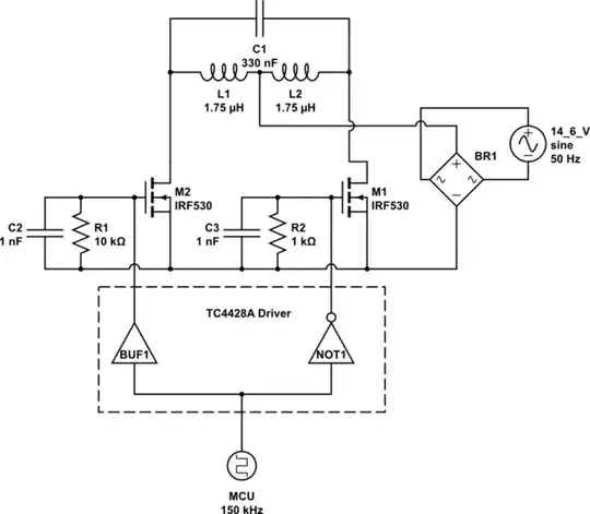

In short I have the following elements in the circuit:
  • Microcontroller to generate pulses with a DC of 50% with its own power supply, sharing ground with the transformer powering the solenoid.
  • Two MOSFETs (100 amperes continues drain current, 150Vds) on the low side to switch the direction of the current through.
  • A 3570 nH solenoid of 11 turns, ~5cm diameter, made of copper pipe with 1 cm diameter. (Planning to apply watercooling through the coil some time later on.)
  • A 230VAC to 12VAC transformer that can deliver up to 35 amperes peak, or 20 amperes for a while.
  • A MOSFET driver (TC4428A) to drive the gates of the MOSFETs.
  • A10K resistor on each MOSFETs gate to source.
  • 1000pF ceramic capacitor on each MOSFETs gate to source (to reduce some ringing on the gates.) Vpkpk is ~17Volts on the gates.
The circuit shorts when I want to apply 48VAC to the circuit using a welding machine. The MOSFETs should be able to handle (48VAC = ~68VDC * 2 = ~~136Vpkpk). Nothing explodes, the MOSFETs are in one piece, but the resistance between the pins of the MOSFETS (gate, source, drain <-> gate, source, drain) are all 0 or very low (<20Ohms). So they broke down.

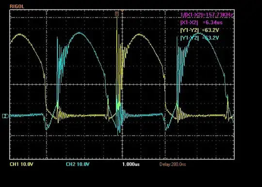

Measurement on Source to Drain with workpiece in solenoid @ ~150Khz
Measurement on source to drain with workpiece in solenoid @ ~150Khz. Shown in the last picture, if the signal was clean, it would yield a Vpkpk of ~41 volts, but due to the spikes it is around ~63 volts.
Would the latter of 150% over/undershoort Vpkpk be the problem? Would this result in a (48VAC => 68Vmax => 136Vpkpk * 150% = ) ~203Vpkpk? How would I reduce the noise on the waves measured on the source -> drain?

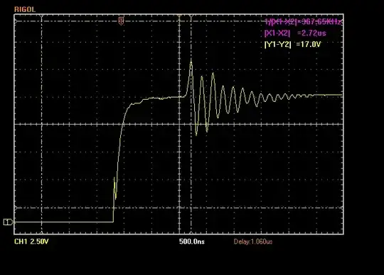

EDIT enter image description here
Here I disconnected one MOSFETs gate from the driver. CH1 is the gate, CH2 is the drain of the MOSFET that was still connected. Now both waves looks fine. No/minimal current was flowing here. When I do connect both MOSFETs to the driver, and measure the resistance between the two gates, it says 24.2K ohm. Could it be that if one MOSFET is turned off by the TC4428A driver, that somehow it still picks up a signal from the other MOSFET's gate when it is turned on by the driver? Is it a meaningful idea to put a diode like so driver --->|---- gate to make sure there is no noise? Preferably a diode with low voltage drop of course.

  • What the heck is that thing you labeled C1? It looks like it's meant to be a cap accross the two coils, but the center tap is tied to a third plate in the middle? Huh??? – Olin Lathrop Jul 08 '13 at 13:18
    Please don't add snubber diodes across the coils - this won't work - you can't use simple snubber diodes on a split winding coil. You need a diode and a zener. The zener voltage has to be above the supply voltage or at least no less than it. – Andy aka Jul 08 '13 at 13:33
  • I don't know how you start this circuit, but IMO applying the power without the square wave is an instant kill for the poor mosfets! Can't you include some safety by measuring the current, either the individual mosfet current or the total (aggregate) current? Next I would drive te mosfets with 2 separate signals, so you can keep them both disabled at startup, and fiddle with the pulse width. – Wouter van Ooijen Jul 08 '13 at 15:42
  • @WoutervanOoijen Because the MOSFET gates are grounded with R1 and R2, they do not conduct when the power is applied without the square wave. You are right about keeping them both disabled. The pulses only reach the gates when a relay is powered, I forgot to draw it on the circuit. – Mike de Klerk Jul 08 '13 at 17:35
  • As you have drawn the circuit either one gate or the other will be high at any one moment. – Wouter van Ooijen Jul 08 '13 at 19:51
  • Wow. @Phil Frost I clearly did not understand and made assumptions that were incorrect. I retract my "just a diode" comment. – Spoon Jul 08 '13 at 22:10
  • @OlinLathrop Its a funny way of drawing that part of the circuit I suppose. C1 is put parallel to the solenoid but is not connected to the + coming from BR1. – Mike de Klerk Jul 09 '13 at 06:08
  • Then -1 for misleading, ambiguous, and sloppily drawn schematic. – Olin Lathrop Jul 09 '13 at 12:39
  • @MikedeKlerk I'd suggest doing something to indicate that the inductors are mutually coupled in your schematic. CircuitLab I don't think has any tapped coil or autotransformer symbol, so just a text note would be good. When I first read it, I thought they were two separate (uncoupled) inductors, which really changes the meaning of the circuit. – Phil Frost Jul 09 '13 at 18:49
  • You may want to move the capacitors to D-S instead of G-S. Now they not only make the response worse, but may actually cause an overlap with that risky 50% duty cycle. I would, in fact, reduce that percentage, so that one side is reasonably well closed when the other turns on. – Zdenek Nov 10 '17 at 21:04

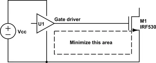

In addition to putting the gate driver close to the MOSFETs, you want to minimize the loop area of the path the current through the gate must take:
The inductance is proportional to the area illustrated.

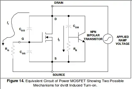

schematic of MOSFET capacitances and current
In your case, if the gate traces are long, then \$R_G\$ is also an inductor. Since the inductor limits \$di/dt\$, the gate driver can only respond so quickly to these currents, and then there is significant ringing and overshoot in the resonance between the gate trace inductance and the MOSFET's capacitance. Your C2 and C3 just serve to change the frequency of this resonance.
As the gate voltage is ringing, it sometimes crosses over \$V_{th}\$ of your MOSFETS, and one begins to conduct a little when it should be off. This changes the current and voltage of the connected inductor, which is coupled to the other inductor, which introduces these capacitive currents in the other MOSFET, which can only exacerbate the problem. But, when the coils aren't powered, then the drain voltage is at 0V regardless of the transistor switching, and these capacitive currents (and consequently, the total gate charge that must be moved to switch the transistor) are much less, so you see much less ringing.
This inductance can also be coupled magnetically to other inductances, like your solenoid coils. As the magnetic flux through the loop changes, a voltage is induced (Faraday's law of induction). Minimize the inductance, and you will minimize this voltage.

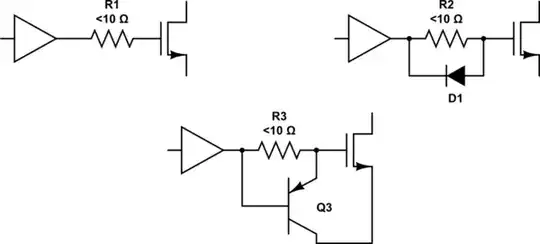

Get rid of C2 and C3. If you still need to reduce ringing after improving your layout, do that by adding a resistor in series with the gate, between the gate and the gate driver. This will absorb the energy bouncing around which causes the ringing. Of course, it will also limit the gate current, and thus your switching speed, so you don't want this resistance to be any larger than absolutely necessary.
You can also bypass the added resistor with a diode, or with a transistor, to allow for turn-off to be faster than turn-on. So, one of these options (but only if necessary; it's much preferred to simply eliminate the source of the ringing):
simulate this circuit
Especially in the last case with Q3, you have essentially implemented half of a gate driver, so the same concerns of keeping the trace short and the loop area small apply.

  • @PhilFrost Hi Phil. Could you take a glance at the last picture I added? I am curious what you think. Thanks. – Mike de Klerk Jul 09 '13 at 06:09
    @MikedeKlerk adding a series diode will just make your gate driver able to turn the MOSFET on, but not off. See edits for more explanation of what you are observing, and more damping options. – Phil Frost Jul 09 '13 at 12:00
  • @PhilFrost Oh, Yes of course... The driver also takes care of discharging the gates. :X – Mike de Klerk Jul 09 '13 at 12:10
  • Thanks for the edits! I will first try with the resistor and bypass discharge diode. As it requires more work to relocate the MOSFETs driver. If RD solution doesn't work, I will have to relocate the driver of course. Thank you so much for your time! – Mike de Klerk Jul 09 '13 at 12:15

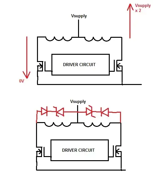

To correctly clamp the voltages on the FET drains to a reasonable value consider this: -
The natural operation of the two coils (if there is any significant magnetic coupling between the two coil halves) is to produce twice the supply voltage on each drain on alternate cycles.
It's like a see-saw with the midpoint (Vs) not moving. Pull one half down and the other rises through transformer action.
This naturally means the FETs have to be rated at least twice the supply voltage or things will fry. Because coupling isn't perfect the zener diodes will catch anything above twice Vsupply.
Recommendations - choose FETs rated at 3 x supply voltage and zener diodes rated at the supply voltage. 5W zener diodes as a minimum too. Get rid of the 330nF capacitor completely - if you think this is going to somehow tune the magnetic filed emitted think again because it just kills the FETs with a current pulse. Maybe 1nF is just about livable-with. Get all connections as short as possible - stray inductance in wires can also be a killer and at the very least give those peculiar gate ringing voltages although, it's likely that these are caused by FET gate drivers with insufficient drive capabilities - in effect the voltage on the drain is coupled back to the gate by internal parasitic capacitance and prevents clean switch-on and switch-off.

    @Mike de Klerk. This type of push-pull bridge drive is absolutely not compatible with a resonant primary - if you drove a parallel resonant circuit with square waves, the harmonics of the square wave get near enough shorted out by the action of the capacitor - you are throwing energy into something that only gets turned to heat. I'd expect this circuit to be drawing in the region of 50mA when unloaded. What are you trying to achieve? – Andy aka Jul 08 '13 at 16:42
  • Commercial cooktops use a resonance capacitor like C1. C1 I use is actually taken from one. See http://openschemes.com/2010/11/11/1800w-induction-cooktop-teardown/ There is one IGBT inside and the coil is powered from one side, instead of from the middle. By using C1 the circuit is actually more efficient as the energy bounces 'up and down' through the solenoid. If there would be no capacitor. The energy would just leave the coil, instead of being preserved in C1. The energy stored in C1 is reused when the other MOSFET opens. But it has to be at resonance, otherwise the circuit is inefficient. – Mike de Klerk Jul 08 '13 at 16:56
    I am trying to achieve a high current that switches direction to create a changing magnetic field that switches polarity. This induces heat in the workpiece (core in the solenoid) to (hopefully) reach the curie temperature which is high enough to melt aluminium so I can cast it. – Mike de Klerk Jul 08 '13 at 17:01
    Powering the coil from one side makes all the difference - now you have a primary that can be resonated and effciently too. You just apply a pulse at the right time to push energy into the LC tuned circuit and it keeps it going. Think about the problem with push-pull - one inductor is always tied to Vsupply and grounded - this could never be a sinewave. Single-ended is the same way as high power metal detectors work that I've seen. – Andy aka Jul 08 '13 at 17:16
  • I have no experience or knowledge of coils powered from one side. I blew the commercial cooktop a long time ago when using a different solenoid on it. So I can't do much measurements on it anymore :( I have to buy a new one again first. As I had no experience with electronics whatsoever i started this project using this source: http://www.rmcybernetics.com/projects/DIY_Devices/diy-induction-heater.htm – Mike de Klerk Jul 08 '13 at 17:43
    @MikedeKlerk Mike, note the inductor in the centre tap of the transformer - resonant royer circuits with tuned primaries are either poor efficiences (linear non-square positive feedback to transistor drivers) or have an inductor in the tap point or in the source/emitters of the transistors. – Andy aka Jul 08 '13 at 18:05
I think the problem may be in the gate drive. There is not deadband in the gate drive to allow one fet to turn off and the other to turn on which results in high shoot thru currents. You may have to use two gate drive signals that some deadtime. 1 on, 1 off, wait x time, 2 on, 2 off, wait x time.
Concentrate on dealing with the ringing gates by damping oscillations with "optimum valued" series gate resistors. Split drivers are available that allow different valued gate resistors to be designed in for gate charge (switching on) and discharge (switching off) times.
One point no one seems to have picked up on is that you're trying to design a ZVS circuit. The drain load has a resonance of approximately 150kHz and your switching at 150kHz. So you're trying to drive the resonant circuit in such a way that when both drain voltages go to zero (inductor current = max) the MOSFETs switch, one from ON to OFF, the other OFF to ON. With no charge on the capacitor both drains have zero volts on them and so, there can be no drain current in either of the MOSFETs. Hence Zero Volt Switching.
The resonant circuit will however magnify the voltage across its 330nF capacitance by a factor dependent on the relative values of L and C (and the effective damping R associated with the work piece you're inductively heating). Once the MOSFET switching has occurred the inductor current, which is at its max, shifts the associated charge (in IL = dQ/dt) into the cap, charging it up to a voltage proportional to the charge the inductor has shifted onto its plates. If your max inductor current is sufficiently high the max volts across the cap, one pin of which is connected to ground via the ON MOSFET, can easily be high enough to exceed the drain source volts of the other OFF MOSFET.
If your drive frequency is not close to the natural resonant frequency of the drain circuit ZVS will not be attained and will result in high dV/dt on the OFF MOSFET drain. This can couple into the gate, switching the MOSFET on at inappropriate times (When Vc is not equal to zero). Also, the OFF MOSFET can switch on at inappropriate times due to gate ringing volts exceeding the gate threshold volts. Either can result in high switching losses which could be responsible for damaging the MOSFETs.
