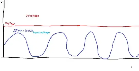

As long as Vin is below Vs/2, amplifier is producing no output. Here's an illustration of input voltage (in blue) and voltage in capacitor C4 (in red):

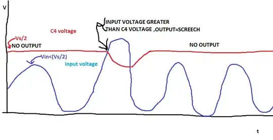

When there's a peak which goes above Vs/2, then the voltage on C4 drops a bit and amplifier does produce output, which looks like it's clipping very hard. Basically a flat line mixed with lower halves of a sine wave. Voltage is usually few milivolts peak to peak. Here's an illustration of C4 voltage (in red) and input voltage (in blue):

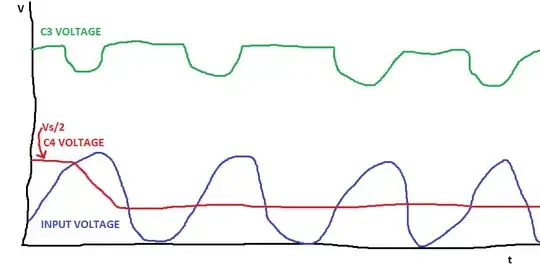

I did some testing with sine waves and I've noticed that once I reach an equilibrium point where the voltage on C4 is around half of Vin peak to peak value, the amplifier seems to start working fine. Here's an illustration of C4 voltage (in red), input voltage (in blue) and C3 voltage (in green).

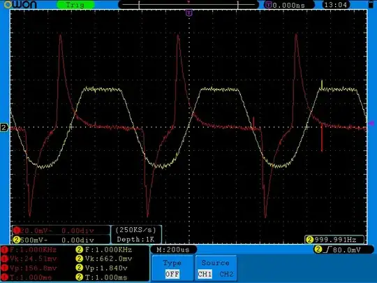

When I tried to do some scope screen captures to post instead of MS Paint drawings and try out some suggestions, behavior of the circuit unexpectedly changed. Note: Scope ground clip was connected to circuit GND during both the original behavior and now.
It seems as if the chip just died. Output voltage at pin 2 is always close to 0 V. There's some voltage at pin 3 and it seems to be related to input signal. When there's no input signal, the capacitor charges. It the lower the supply voltage, the higher is the voltage the capacitor reaches. This behavior seems to be extremely similar to the behavior before output on pin 2 died.

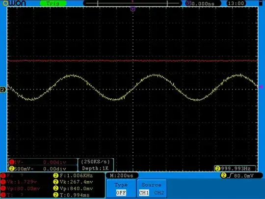

Here's a picture of the charged capacitor and input signal (capacitor red, input yellow):
Once input voltage reaches certain level, capacitor starts to discharge and reaches this point:

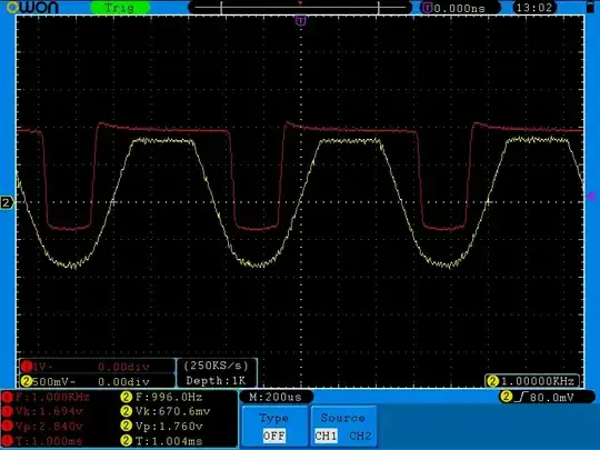

Without a capacitor C4 on pin 3, output looks like this:
If remove capacitor C2 and take a look at pin 2, I get this (pin 2 red, input yellow):
When I increase input signal amplitude, pin 2 output turns to this:
Back before the mysterious change, output had DC bias even with no input voltage, as expected, but now there isn't any.
