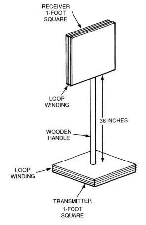

Transmitter/Receiver Detector (75 year old technology)
Suitable for locating large metal objects at greater depths—feet instead of inches.
The basic system is shown below.
Two non-metallic boxes serve as the 2 housing for the electronics and the forms for the loops. The transmitter and receiver boxes are mounted on a 3-foot-long wood or plastic handle, with the receiver placed in a horizontal position and the transmitter in a vertical position.
The 90-degree relationship between the transmitter and receiver allows for minimum transfer of signal between the two loops. Placing a large metal object between the two loops causes the transmitter's field to distort, allowing some of the signal to reach the receiver's loop. The signal is amplified by the receiver and indicated on the meter as metal detected.
enter image description here Transmitter circuit
enter image description here Receiver circuit
see http://www.talkingelectronics.com/projects/200TrCcts/MetalDetectors/MetalDetectors-1.html

  • Jim, just so you know, I've added an edit to my post explaining why I think the 3-coil arrangement I proposed is probably better for this job. I'm letting you know because you did a perfectly decent answer and the op asked me to make a judgement that I felt I was able to give. See the edit in my post (if you are interested) – Andy aka Jul 09 '13 at 20:08
  • @Andyaka As they say there's more ways to skin a cat. My first positions were in instrumentation (many decades ago as you say - not quite 75 years though!). I'm quite happy you've come up with a better solution. I've only been on this site a short time but I've followed your posts with a lot of interest. So +1 from me – JIm Dearden Jul 09 '13 at 20:35
  • Cheers dude, appreciated. – Andy aka Jul 09 '13 at 20:36
