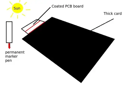

Using the Sun.
The Sun's intensity will vary considerably so its not really a good 'constant' source like the LEDs.
enter image description here However, the basic method would be to get a coated board and cover it with a thick card (mask) . Every two minutes Use a permanent marker to indicate the edge of the card on the board and then move the card down exposing a fresh 1 cm strip. When the board is completely uncovered you can develop it and see what time the strips were under exposed, correctly exposed and over exposed.
