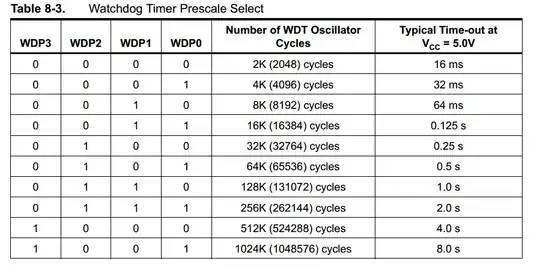

If you want a period different than every 1 second, you can use these values here to set the apropriate bits in WDTCR...
Note that you do need to execute the timed sequence to change the timeout. Here is code that sets the timeout to 1 second...
   WDTCR = _BV(WDCE) | _BV(WDE);                   // Enable changes
   WDTCR = _BV(WDIE) | _BV( WDP2) | _BV( WDP1);    // Enable WDT interrupt, change timeout to 1 second
