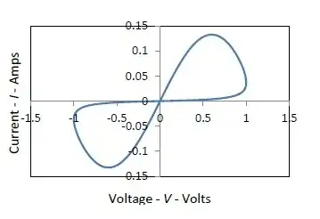

The example curve above shows a lot of noise and nonlinear behavior, probably owing to the less than carefully engineered nature of the setup. Here's a more idealized version of the same thing:
memristor I-V curve
(from Electrical Charging of Memristors)
This shape is pretty typical, but according to most definitions of memristor, this particular shape isn't required, as long as there is a pinched hysteresis loop that passes through \$0V, 0A\$. Consequently, there isn't just a scalar number that describes an "ideal" memristor as there is with resistors, capacitors and inductors. Rather, the slope of this curve is specified as a function, in units of volts per amperes, or ohms.
