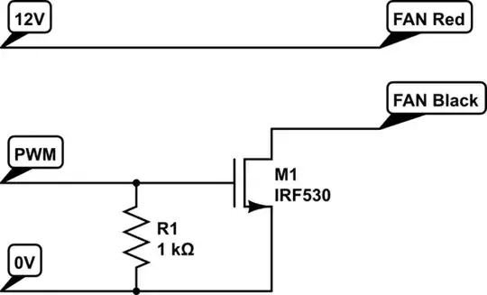

100k is way too much resistance for reliably driving the gate off for a MOSFET doing PWM. It might work OK with a 1k pull-up (I'm talking about R3.) Better would be to use a dedicated MOSFET gate driver.
However, you could likely replace the entirety of R1/Q1/R3/Q2 with a single MOSFET N-channel low-end switch. Hook the fans between +12V and the drain of the MOSFET. It would be equivalent to your circuit. Again, for best gate drive control, try a smaller resistor, such as 1k, for pull-down.

  • @JIm Dearden: Your solution will likely not work when driving the gate using PWM. It will likely keep the MOSFET in the half-on zone, overheating and killing it. The reason for that is the way-huge 100 kOhm pull-up resistor, as I suggested. – Jon Watte Jul 02 '13 at 18:37
