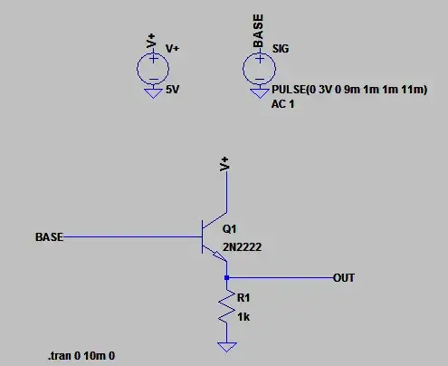

Let's say we have this setup, and Q1 has a current gain of 200:
CE
Now say we apply 3V to the base.
We know that the transistor begins to turn on when the base is ~0.7V higher than the emitter, so at this point current starts to flow from V+ into the collector and out through the emitter through Re to ground.

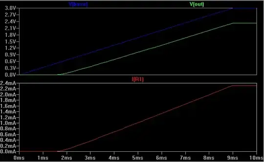

Here is a simulation of the above circuit, with the base voltage gradually ramped up from 0V to 3V:
CE Simulation

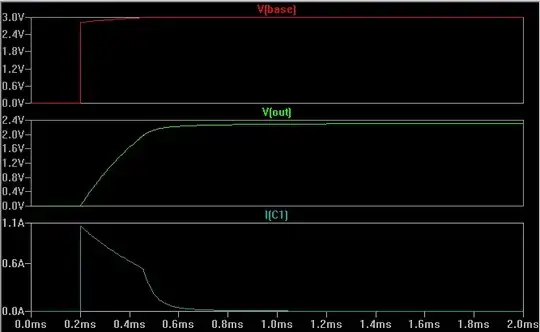

Here's another simulation with a capacitor added in to prevent the emitter voltage from rising too quickly, so we can see how the transistor turns on fully at first to charge the cap as quickly as possible, then (almost) turns off again as the cap reaches ~2.3V and only the resistor current is left as things settle:
CE with cap
Simulation:
Ce with Cap simulation
