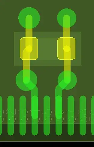

I searched a technology document about placement of decoupling capacitors and the main idea is shown in the following picture: enter image description here
I think it is reasonable but do I have to put the decoupling capacitor and MCU in the same layer? it is not convenient for me to place other devices. So i choose to place the decoupling capacitor in the bottom layer
My PCB is a four-layer(signal-power-gnd-signal) one and when I split power and gnd layers the two vias closing to the pins of MCU in the above picture will not be included in net of power and gnd layer. Does it have the same nice performance as the case f in picture one? Do i have to take of inductance of vias in this case?

  • By trying to place your decoupling capacitor on the bottom side you have defeated the whole idea of having a direct no vias copper connection between the device pins and the capacitor. With the high switching speeds that occur in today's ICs this direct copper connection is more important than ever. Intervening vias add series inductance to the trace and effectively decouple the capacitor from the IC pin. – Michael Karas Jun 30 '13 at 13:31
    A lot of chip suppliers will specify how to decouple the chip you are using and apart from (e) the other methods will work for a vast array of devices whether on the same layer or not. However, for some devices the caps have to be camping on the pins virtually. The sort of device I'm thinking of is SMPS chips, hi-speed comms, rf devices etc.. Read the manufacturer's blurb - there's nearly always something mentioned on layout preferences. – Andy aka Jun 30 '13 at 14:13

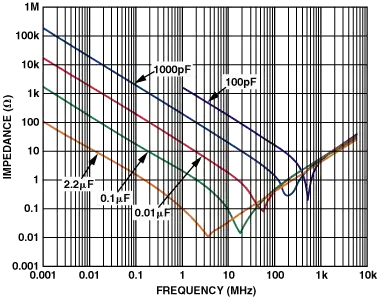

While this answer is sort of a side point, it addresses some assumptions. We are talking about bypass caps which only concern is high frequency noise and not large power draws. High frequency noise is best dealt with using monolithic ceramic caps (ESR less of a concern as it is just your minimum impedance achievable). Larger power fluxes need bigger tantalum caps. See the frequency performance here:
caps by type

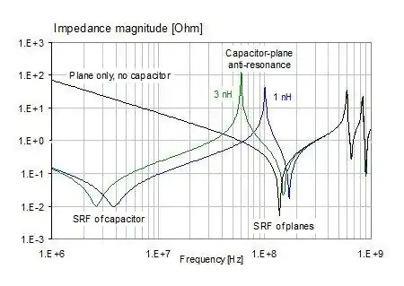

You can use the SFR (self resonant frequency) to your advantage. If you have a problem with say a 1GHz clock leaking through, you can start by adding another bypass cap that is self-resonant a little higher than 1Ghz. 0402 10pF (from experience, not from the graph) are pretty self-resonant around 1Ghz.
Self resonance
However this is only part of the story. What happens at higher frequencies? The mounted inductance plays a role and that is where the layout also comes into play between the layers in the board. For example a power layer and ground layer in the board with an SMD cap has the following mounted inductance loop model -- shown in red:
SMD inductance
In an example of 2 planes (power/gnd) in FR4 you can see that at high frequencies even the mounting of the capacitor can make a big difference. The black trace is without the cap. The blue and red show two different mounting topologies that show different mounting inductances.
The anti-resonances can cause more problems at high rates. And you might think you don't care about 1GHz+ noise, but the FCC might, and if you want clean edges on your digital 500Mhz signals, then you're going to need a lot of harmonics for that square wave. For example a 100Mhz clock to have a 0.5nS rise time needs at least a 900Mhz harmonic.

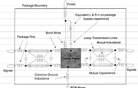

So what about the package itself? You've got output drivers, input pins, bonding wires, ground pins, power pins...(fyi ecb=pcb)
package

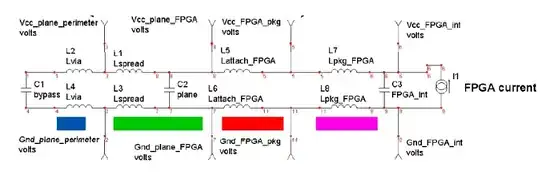

A full model would look something like this (including cross-coupling effects). The cavity plane is where the die would be represented. (Ignore the part with the Equivalent L+R for package Bypass Cap--that bit for a ic bonded with some on board bypass which isn't the case for this question).
model
Using microwave probes, a high frequency network analyzer and special TDR calibration fixtures the impact of the package both in terms of power/ground planes and cross coupling can be estimated.

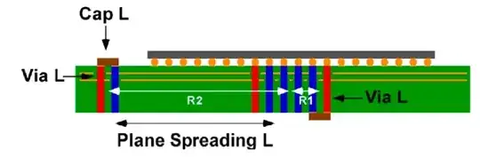

Now on top of all that we have your question of where to put the cap. I found a nice article by Howard Johnson who shows how to do a model of the system and how to analyze and measure it. Here's an example layout and how to look at each part and optimize it.
Layout
Model
Unfortunately the presentation doesn't go over your specific case of IC to vias or IC to cap to vias. You could play with the model and see which provides more bypass but remember the cap effects, and the power to ground plane coupling. My bet is if the chip is your noise source minimizing all inductance between the die and the cap would provide the best results assuming the vias for the cap are also near and symmetric like Case F.

Case F optimizes the above layout model of the uC noise source by \$L_2=L_4=0\$ and \$L_1=L_3=minimum\$.
From the comments in the discussion with David about BGA's where placing the bypass on the back side of the board with vias can be ok and often the optimal choice. This is because even though \$L_2=L_4\ne0\$ you can really reduce \$L_1=L_3=small\$ and the overall solution is better than making long traces to the bypass cap without using vias. In addition the BGA package style has less inductance which helps with bypassing.
In addition this model shows why the layout should be symmetrical as possible to make the bypassing cap most effective to reduce both ground bounce and supply spikes by keeping both ground paths and power paths as similar as possible.

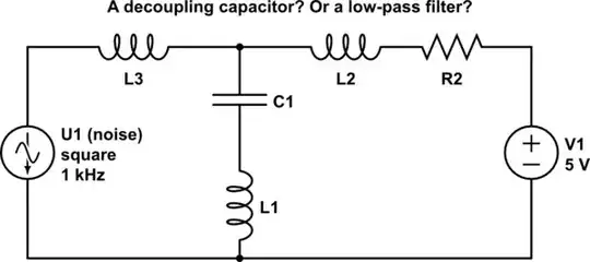

Your goal in placing the capacitor is to reduce the AC impedance of the supply rails. You want to do all of these things:
  • minimize resistance
  • minimize inductance
  • maximize capacitance
Assuming the trace lengths are reasonably short and thick, the resistance will be negligible relative to the inductance. Adding more capacitance is easy. Minimizing inductance is the hard part.
Calculating inductance exactly is complex, but there's a rule of thumb that's simpler: inductance is proportional to the area enclosed by the loop in which the current flows. Since at high frequencies, the inductance (not the resistance) of the power rails is the more significant impedance, your goal is to make sure the inductance through the decoupling cap is lower than the inductance through everything else. Ideally, by a large margin, since what you are essentially making is a filter that attenuates high-frequency noise generated by the IC to the power supply rails.
If you place C1 on the bottom, then you are adding more inductance at L3 by requiring the noise current to go through vias. It's worse than having it on the top, but is it good enough? It will depend on your application and how much noise you can tolerate.
If you are going to have four vias as in your proposed layout, it would be better to have all four connected to the power planes. Also, get them as close to the pads as you can, such that you don't even need traces to connect them. This will minimize the overall inductance. You don't need to worry about making the noise currents go "past" the capacitor. The inductance of the supply rails (L2) will force the high-frequency current to do that, since the rails are so much bigger and have so much more loop area. Instead, focus on minimizing the inductance to your capacitor (L1, L3).
Also, keep in mind that although increasing L2 would improve the filter, if you do it by moving the vias connecting the capacitor to the power planes far away (as in your example F), then you are doing it by including a loop antenna in your layout. This will give you worse EMI performance and worse ground bounce. If you must add impedance here, use a resistor or an inductor with low leakage. Rarely would I think this is necessary however: inspect some very high-speed layout like a PC motherboard around the CPU, and you won't find any L2 or R2 beyond what's unavoidable and intrinsic to the layout. If you are going to add another component, why not add another decoupling capacitor, which will double the capacitance, and halve the undesired inductances?

    what do you mean by "a decoupling capacitor or a low pass filter"? it is new for me to consider as a low-pass filter. but i think it makes me clear. it tells me that i should make R2 bigger. then the time constant will be bigger and cut-off frequency will be smaller, so no more high frequency noise will go to power rail. one way to make R2 bigger is to have a local power shape connecting whole power rail at a single point. is it reasonable? – oilpig Jul 01 '13 at 04:51
  • @oilpig I mean, if you look at the schematic, it is a low-pass filter. Making R2 or L2 bigger will indeed improve the filtering performance. One way to do that is to actually add a resistor or inductor. Of course, this also increases the power supply impedance, which can be a different problem. Usually, the impedance of the supply is already enough, and L2 or R2 is added only for very sensitive or noisy components, or to filter power for whole sections of a board. – Phil Frost Jul 01 '13 at 11:22
  • @oilpig also, see edits. – Phil Frost Jul 01 '13 at 12:08

I had one PCB where the capacitors for the ADC were on the opposite side of the board from the ADC. I measured significantly less noise after I took off those capacitors and kludged added capacitors to the power pins of the ADC on the same side of the board. My understanding is that the improvement is entirely due to eliminating the via inductance.
There seem to be 4 cases.
  1. The capacitor sits across the IC power pins on the same side of the board. The loop goes from the capacitor, in one power pin, out the other power pin, back to the capacitor. For most chips, this gives the least loop area, minimizing inductance.
  2. The capacitor sits on the opposite side of the board, and the 4 vias between it and the chip are connected to the power and GND planes. The loop goes from the capacitor, through 2 vias in parallel, in one power pin, out the other power pin, through the other 2 vias in parallel, back to the capacitor.
  3. The capacitor sits on the opposite side of the board, and the 2 vias between it and the chip are connected to the power and GND planes. The loop goes from the capacitor, through one via, in one power pin, out the other power pin, through the other via, back to the capacitor.
  4. The capacitor sits on the opposite side of the board, and the 2 vias between it and the chip are carefully isolated from the power and GND planes. 2 other vias connect the capacitor to the power and GND planes. Isolating vias so they don't connect to the power or GND planes can only increase the total net impedance, making ground bounce worse -- I can't see any reason to ever do this.
(2) and (4) have the vias arranged in exactly the same locations, occupying exactly the same space.
Some high-speed digital devices and some high-precision analog devices require you to use (1) -- the other options won't work at all. Such devices will usually specifically mention this in the data sheet.
Some devices will work adequately with options (2) or (3). They have worse ground-bounce and worse EMI/RFI/EMC, but if the result is still well below the FCC limits and works adequately, it may be worth it in order to make routing simpler.

  • the reason that i place the capacitor using pattern (4) is that noise from MCU can not go to power or gnd layer directly. they must go through this cap first. Does it have any problems? – oilpig Jul 01 '13 at 00:47
  • in addition, i have some questions about your loop from(1)-(4).the current should flow between power and gnd layer.so, (1):power-via-cap-MCU-via-gnd;(2)(3)power-via-cap/MCU-via-gnd;(4)power-via-cap-via-MCU-via-cap-via-gnd; (1)and(4)can isolate noise from MCU to POWER/GND, for convenience, i choose(4). – oilpig Jul 01 '13 at 01:01
  • I don't quite understand your question. Perhaps you could post it as a new top-level question, as recommended by ["Do not post follow-up questions as answers. Ask a new question instead."](http://electronics.stackexchange.com/help/answer-bans) – davidcary Jul 03 '13 at 22:46
