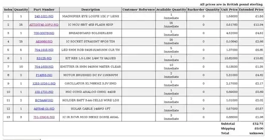

Any/all of the above sound like fun and I would really like to try and do at least 1 or 2 of them. I have absolutely no electronic related stuff at home. What should I get and what will I need? So far this is what I have thought of:
Part numbers can be looked up on the Digikey website but I can't post any more links.
I am hoping to be able to program my microcontrollers with my Raspberry Pi. I am still missing jumper wire as I couldn't find any on Digikey. I think I will also need some transistors but I'm not sure which ones to get. Would I be able to run the DC motors with some transistors from the microcontroller?
I don't have a good soldering iron (I have one somewhere but I honestly don't think it can even melt the solder) and I do not have a multimeter. However together getting those will likely already come to £50. Do you think that they are essential to get started?
Thank you for reading. I really would be interested to know what you think is most important to get first when starting out and what other items I have missed from my list that I will need.

    -1 For question that is off topic for this site. Questions should relate specifically to design problems you encounter doing your electronics project(s). Your effort at "getting into electronics" is going to have to entail a batch of decisions that you have to make considering all the limitations and road blocks you have set before you. My best advice for you is to stop trying to meet every goal within £50 and simply get started on one thing at a time. When you actually get hung up on a design problem come back here and read existing questions and ask new ones if necessary. – Michael Karas Jun 30 '13 at 10:14

    I use Digikey from Australia to purchase specialist parts (their service is A1) but I assume you're in England? I can't help but think you'd be better to find a small local shop you can purchase from as required and they'd probably be happy to advise you at the same time. – PeterJ Jun 30 '13 at 10:18
    You should also consider looking at eBay. You can get many parts from there for very low prices, often with free shipping. – Michael Karas Jun 30 '13 at 10:22
  • there are a lot many things to consider to setup electronics. Things change and you cannot keep running for new components and parts as far as pet projects are concerned. I bough everything with multiple functionality, which was quite costly to start with but in the long run it saves you a lot of money. – David Norman Jun 30 '13 at 10:24
  • If you get really small and cheap micros, you will find projects they can't do after not too long. I would get a handful of something like the PIC 18F2620 and learn it well. It's only 28 pins, but has a lot of capabilities you can use once you get that far. In the mean time, just leave them off and start be learning the basics. – Olin Lathrop Jun 30 '13 at 12:15

  1. Your choice of microcontroller. Although ATTINY45 seems good, reading the ideas of your pet projects I would recommend either ATmega168 or even better ATmega16L. These two microcontrollers are 4 times in cost as compared to ATTINY45 so it might cost 2 to 3 bucks in your currency.
  2. What type of IDE are you going to use and what type of programming interface such as JTAG, ISP or Parallel Programming are you going to use?
  3. With ATTINY45, you do not have enough pins to run LEDs although you might be able to debug with 3 atmost because it doesn't have enough pins
  4. Although using 3 AA batteries would be a good idea for portability, they might run out fairly quickly and might cause unwanted problems when the batteries start to die out.
As for transistors, you can get plenty of general purpose transistors like the BC546 (my personal favourite) and YES you can run DC motors with transistors but small motors which you find in battery operated pencil sharpers, hand-held fans, etc as running motors will draw quite a bit of current which will make your transistor hot or even damage it.
If for instance you setup everything and things do not seem to work, you would need a multimeter. Its quite an essential tool when setting up the hardware. You do not need solder if you are using a breadboard. Breadboards can be quite expensive and you might want to go in for veroboard (or pre printed circuit board) for which you will require a soldering iron. I do not know what the prices are for tools like these in your country but if you do get a hot iron, do not save money as buying a good iron will save you money in the long run (speaking from past experience).
