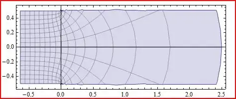

Here is an example (adapted from some work I did forever ago) of what magnetic field fringing near a gap looks like, and how it falls with distance in the free field region:
Figure shows a semi-infinite gap. Gap length is 1mm in y, span is infinite in all of z and negative x. Fringing area goes out 2.5 gap lengths where the field would be down by about 98%. So, of the three types of fields you won't have to be as far away to limit exposure to a magnetic field.
A Gap Rule of Thumb ... and Why You Can't Use It Blindly
A basic rule of thumb for gaps is that the fringing will extend normally away from the core by the amount of the gap length. Say you have a 1mm gap, then 1mm away from the gap and core, field strength will be down by 85 to 90% of what is in the gap.

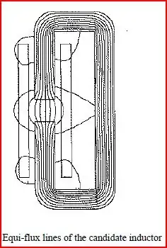

Does that mean anything placed 1 gap length away would have low field in it? Nope. Here is what you don't have going for you. The magnetic field will always find the path of lowest reluctance (or highest permeability) available. If a ferromagnetic material is placed near the gap the field will be distorted from the free field case. Here is an example of what that looks like for ferromagnetic material about 2 gap lengths away from the gap:
Figure from: A. Keyhani, "Minimum Loss Design of a 100 kHz Inductor with Litz Wire", IAS Proceedings 1997.
You can see how the field lines are distorted by the ferro-magnetic material. This would put about 20% of the fringing region field into the external material to generate eddy current losses. So, you would probably want to have at least 5 gap lengths of separation between the gap and extraneous steel housing.
