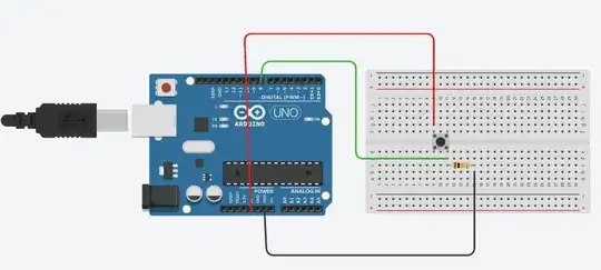

So when we don’t use pull down resistor we get the floating values that’s why we use this resistor to ensure that the reverse digit is delivered when we pressed the button but why we get the floating values, I’m not sure but may be the micro controller unpredictably take the input from the pin as logic high or low so I think may due to this we get the floating values.
And if we don’t use pull up resistor then make a ckt and we can see that this always gives high value at output. (Here i consider using a switch and read the value throung a pin connected to arduino) But this concept apply everywhere enter image description here
Mwrr221
  • Please don't use Fritzing diagrams, they are difficult to read (for example you describe this a s a "pull up" but really this is a "pull down"). Also the pin can "float" but the value you get on the pin will be a 1 or 0, there is no "floating value" (unless it's analog). – Ron Beyer Nov 21 '21 at 22:33
  • Hey i describe the both condition and below in figure i only illustrate the pull down resistor condition and it is from tinkercad ,can you tell me if i could not use the tinkercas fugure then what can i use .i thought it is good to have a diagram for better understanding thats why i put it there – Mwrr221 Dec 11 '21 at 10:31
