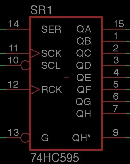

In Eagle, I would like to include SN74HC595 shift registers in my project. I found a library online a few months ago (can't find source anymore) that has this part.
The symbol looks like this:
However, I noticed the symbol does not have power and ground pins, which is contrary to all of the other devices I've seen and created before. I had no idea how I would actually connect it to the same power supply I'm using for all other components in my schematic.

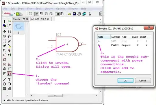

31
"Invoke" command resolves this.
I've got only Eagle 5.11.0 in front of me at the moment. But, this haven't changed in 6.3.0
@ScottSeidman had beat me to the answer, while I was annotating the screenshot.

You use the INVOKE button. enter image description here It looks like four AND gates with an arrow on the lower left one. It will let you hook up pins that are attached to default nets.
