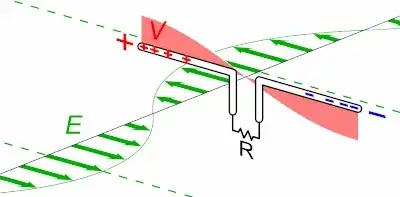

I'm guessing you don't understand how current can flow if there is no complete circuit. Let's take a simple quarter-wave dipole as an example:
How can any current flow, since there is no complete circuit from "-" to "+" of V1?
Consider this: relative to the speed at which the waves in the electromagnetic fields propagate, the dipole is long. It's true that current can't flow, but it doesn't know that until it gets to the end of the wire. As the current approaches the end of the wire but has no place to go, the charges pile up until they are pushed back in the other direction. By the time it's back, it's travelled \$\lambda/2\$ or experienced a \$180^\circ\$ phase shift. The voltage at V1 has also changed by this point, and so the current is constructively adding to the new currents being produced by V1. If it were not for some of this energy being lost as radiation, the energy in this antenna would grow without bound.
Why the energy radiates is complicated. The long answer is "Maxwell's equations". If you don't want to understand all the gritty details of that math, then here's a simple, incomplete understanding: the current in an antenna is associated with a magnetic field, and the voltage is associated with an electric field. An antenna is an arrangement such that at some distance away from the antenna (the far field) these two fields are mutually perpendicular and in phase, and what you get is a self-propagating wave like this:
Red is the electric (E) field, and blue is the magnetic (B) field. This is the sort of wave that would be emitted by a dipole aligned with the Z axis.

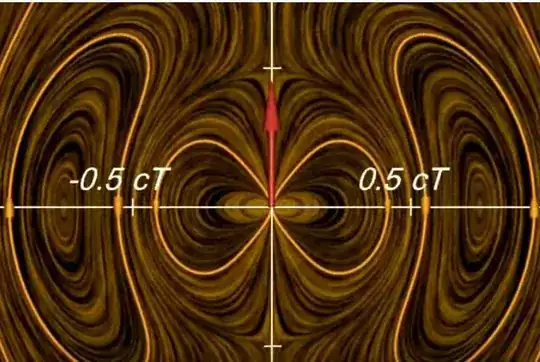

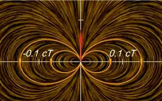

Here's an oversimplified version that helped me get past my own noob ignorance.
There are basically two types of small antennas: the small loop antenna, and the short dipole antenna. The small loop antenna is just a ring of wire, and any current in the wire produces a magnetic field surrounding the antenna. The device is an inductor, but one that has a large space-filling magnetic field.
On the other hand, the short dipole antenna is just a pair of metal "capacitor plates" sticking out into the air, and if a voltage is applied across them, there will be an e-field in the surrounding space. The device is just a capacitor, but again, it has a large space-filling field in the surrounding region.
Apply a sine wave instead of constant volts or current, and the fields around the "antennas" will expand, then contract to zero, then expand again but pointing backwards ...then repeat. No waves are generated, so they really aren't radio antennas at all. But they are creating some local EM fields in space.
Here's the "TEAL" video project at MIT with a visual version of the process:
YT VIDEO: Expanding/contracting e-field
OK so far? The loop antenna generates a magnetic field, and the dipole antenna generates an electric field. The weird stuff starts happening when we drive either antenna with very high frequency. That, or we can build a version of either antenna with such a large size that even 60Hz will be a type of "radio signal" as far as the antenna is concerned.
Here's the thing: the magnetic or electric fields surrounding those antennas cannot expand or contract faster than the speed of light. So, what happens if the AC pulses applied to these devices are "too fast?" The fields around inductors or capacitors have to balloon outwards and then get sucked back in again, but what if the speeds are nearly the speed of light? That's when the fields stop acting like inflating or contracting invisible balloons. Instead the fields start behaving as waves.
So, when we reverse the polarity during the AC sine wave, the e-field or the b-field doesn't get entirely sucked back in as usual. Instead it peels loose from the antenna and just keeps moving. Some of the field-energy isn't retrieved, and instead is lost into space. Our loop antenna is no longer just an inductor, and it's started making waves. And our dipole is now a wave-launcher and not just a capacitor.
YT vid: EM fields surrounding small antenna
