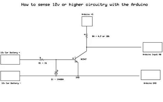

I am looking to detect 12+V from a car wire using an Arduino.
I have found the following schematic:
I know how crazy automotive voltage can get so I just want to make sure the schematic I found above will accommodate the crazy random currents that the car could produce.
Also, wouldn't I need some type of heat sink taken that I am stepping down a +12V to 5V or less? That, in my mind, would produce a pretty good amount of heat?

    A simple resistive voltage divider would work best in this case. A transistor is only needed to step up the voltage for whatever reason. A heat sink is not necessary because the current through the components is not very high. The more power consumed by the components (P = I * V) the more heat will be dissipated. https://en.wikipedia.org/wiki/Voltage_divider – Kurt E. Clothier Jun 24 '13 at 05:10

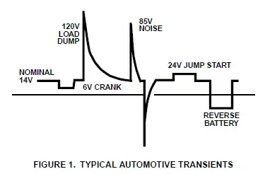

    Kurt - you're right _in theory_ but in practice automotive systems are subject to lots of variation + spikes + EMF so if you had a divider that produced a reliable logical 1 @5v (so at least 3v, probably 4v to be safe when cranking) from 12v, it may go high enough to damage the arduino when the car is charging (modern "smart" alternators will run to nearly 20v at times). StealthRT's circuit is very reasonable and I've seen many similar use in automotive applications. – John U Jun 24 '13 at 08:23
    For reference: www.industrologic.com/autotransients.pdf – John U Jun 24 '13 at 08:40
  • One could follow the 2-resistor voltage divider with a Zener diode, though. – TDHofstetter Aug 24 '14 at 11:53

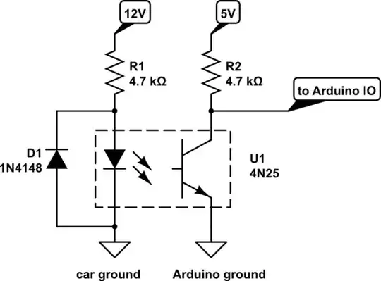

Knowing that all sorts of weird stuff can happen in automotive power circuits, and not being especially knowledgeable in those systems, I'd err on the side of caution and use an opto-isolator.
Pin 1 = Car 12v R1
Pin 2 = Car Ground
Pin 3 = NC
Pin 4 = Arduino Ground
Pin 5 = Arduino 5v R2
Pin 6 = NC
With this scheme, your Arduino and the car aren't connected electrically at all. At worst, the optoisolator is destroyed, and you can replace it for less than a dollar. Put it in a socket and you won't even need a soldering iron to perform the repair.
R1 was selected such that input voltage transients up to 120V won't exceed the maximum forward current of U1. D1 avoids exceeding the maximum reverse voltage of U1 if the input voltage is inverted. The value of R2 isn't especially critical, so it might as well be the same value as R1.
You won't need any heat sink. Heat is the result of electrical energy being converted to heat, and power is the rate of energy conversion. Power \$P\$ in an electrical system is the product of current \$I\$ and voltage \$E\$:
$$ P = I E $$
So, the voltage itself doesn't make heat: it also depends on how much current is flowing. In both these circuits, the current is low enough that the power is small and no heatsink is required.

  • +1 for optocoupler, this is practically what they were designed for in the first place. – shieldfoss Jun 24 '13 at 13:38
  • I like this. That 4N25 is 25 cents at Jameco (as an example). – mikeY Jun 24 '13 at 15:09
  • @Phil Frost do you happen to know what the pin out would be? does the 12v come into pin 1? The 5v comes into pin 5? – StealthRT Sep 12 '13 at 22:05
  • @StealthRT if either of those pins see 12V or 5V with respect to their respective grounds (pins 2 and 4), a 4N25 will be destroyed. See the datasheet for the pinout, and acceptable operating conditions. – Phil Frost Sep 13 '13 at 11:42
  • @PhilFrost i did look at the pinout.. but wasent sure which should be used. So i was wrong about the pinouts? – StealthRT Sep 13 '13 at 14:24
  • @StealthRT what do you mean "which"? Is there more than one? You are wrong in that 5V and 12V are not connected to any pin at all. Look at the schematic, note the resistors. – Phil Frost Sep 13 '13 at 19:33
  • @PhilFrost yes... i meant as a guide i was saying the line for 12v and 5v... – StealthRT Sep 13 '13 at 19:49
  • @PhilFrost quick question: For the 5vdc->4k resistor->Arduino pin->4N25 pin 5... does it really need 2 forms of 5vdc? One coming from the Arduino pin (5v) and another separate 5vdc? – StealthRT Jan 04 '15 at 04:01
  • @StealthRT An IO input pin is not remotely equivalent to a 5 VDC power supply, so it's not "2 forms of 5vdc". Yes, it's needed. If there's a way to configure the Arduino to have internal pullups, then you can just get rid of R2 and the +5V, but I don't really know enough about Arduino to say. – Phil Frost Jan 04 '15 at 13:32
    As said by @PhilFrost one comment ago, you can use the internal pull-ups instead of R2. These are configure in Arduino using [`pinMode(pin, INPUT_PULLUP)`](https://www.arduino.cc/reference/en/language/functions/digital-io/pinmode/). – heltonbiker Jun 09 '18 at 21:51

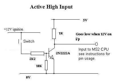

You are on the right track, never hurts to have the reverse diode in there although you can belt-and-braces it by sticking an 18-22v Zener in its place.
This is a similar version, widely used and works fine: http://www.msextra.com/forums/viewtopic.php?f=101&t=40330
Some good background info on the nature of transients in automotive applications Harris appnote , for starters this graph says a fair bit:
Here's the circuit from the forum link above: Circuit for reference

  • Where's the reverse diode / zener you mention? I don't see any such thing in the schematic. – Phil Frost Jun 24 '13 at 13:44
  • It's not in that circuit, but if you replace the diode in the OP's circuit with a Zener it will protect against over-voltage as well as reverse-voltage. – John U Jun 24 '13 at 15:25

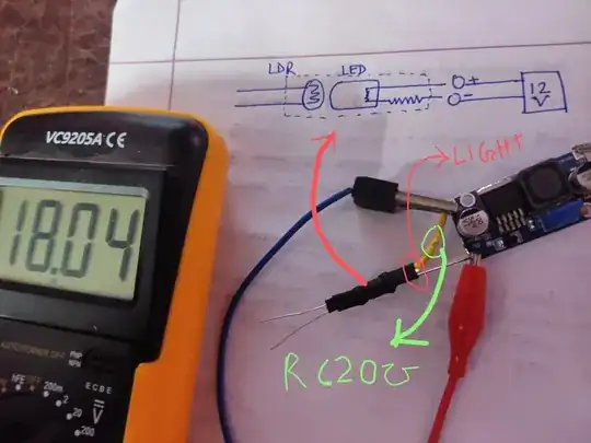

It may be a bit late, but what I did is very simple. Understand this, optocoupler is the way to go to make your entire circuit simple and isolated from the car/motorcycle power system. But, instead of buying one, you can build one within 10 - 30 cents. Using a 3.2V white LED, ~620 Ohm resistor and a LDR. Now its just a simple LDR voltage reading on your Arduino side to detect whether there is any Battery (+) Positive is connected or not (engine on/ battery connected).
Connect 620 ohm resistor to the negative pin of the LED. Then connect the 12V negative with the other end of the resistor. Connect the Positive 12V terminal with the positive pin of the LED.
The good part is, it can handle voltage up to 19 Volts.enter image description here
