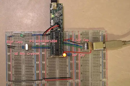

USB + Microstick II Device circuit

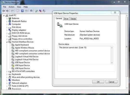

However in Windows, I'm getting an error: This device cannot start. (Code 10)
Win7 Device Manager Error
I've been trying to fix this for a while. After redoing my breadboard wiring last week to try and improve the signal quality, I've come, trying to alter my code to get things working.

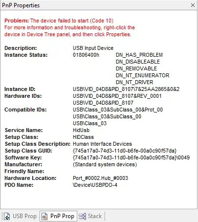

What I've done is light up an LED on Pin 2 (RA0) when USBDeviceState == CONFIGURED_STATE, and all I know is that the device is in CONFIGURED_STATE, as the LED lights up a few moments after the device is plugged in. I also managed to get the following from the USBLizer trial version:
USBLizer
I can't set breakpoints in MPLABX, and halt the MCU to investigate the issue, because of USB clock timing requirements, so really stuck as to how I can troubleshoot and fix this.
