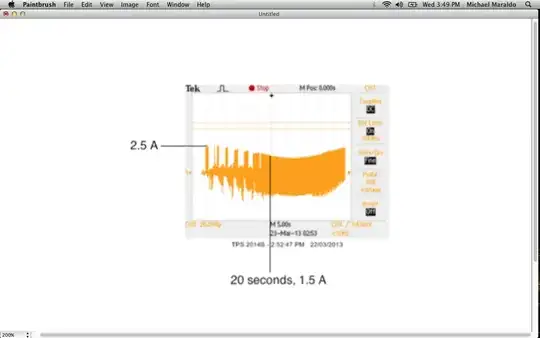

There are lots of ways that your circuit can blow mosfets. The ZVS Royer started life with BJTs many decades ago. MOSFETs are better than BJTs these days but you need to do a bit more work to get some reliability. First you should run the circuit up on a current limited source like a lab supply or failing that a large idiot resistor. This will stop things blowing allowing further work. Now scope each Drain Source of each fet and you should see a half wave rectified sinewave. The drain waveforms should be the same if your coil has proper symmetry. There should be no parasitics. If there are use gate resistors to improve this. Parasitics can and do mean increased power dissipation and increased voltage peaks. The expected peak drain voltage under steady state operation is Pi * the supply volts. Measure your current draw under this steady state operation and calcutate the total power that is being wasted. Most of the wasted power goes into the transformer and the mosfets. Now measure your drain current with a CT or other fast means. Study the way the mosfet current interacts on the scope with the Drain Source voltage and you should observe Switching at low volts meaning low switching losses.If you get poor switching then redesign the drive circuit. The drive circuit I use is more complex but means no heatsinks needed on the FETs. Now you can substitute the idiot resistor for a buck convertor that has current limiting and preferably soft start.
I used a S trap switchmode current source using descrete components but you can choose a chip if it is easier for you. This caper of pre bucking the ZVS ROYER is not new, in fact linear technology have a chip that does this for old flouro LCD backlights.
