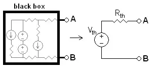

Lastly, Thévenin's theorem says that we can transform just about any linear electrical network into a voltage source and a resistor:
In fact, "source impedance" can be defined as the Thévenin equivalent resistance, \$R_{th}\$ here. It works for loads also. But unless you already know Thévenin's theorem, that's not a useful thing to say. However, understanding what source and load impedances are, Thévenin's theorem means you can calculate an impedance for linear networks, regardless of complexity.
