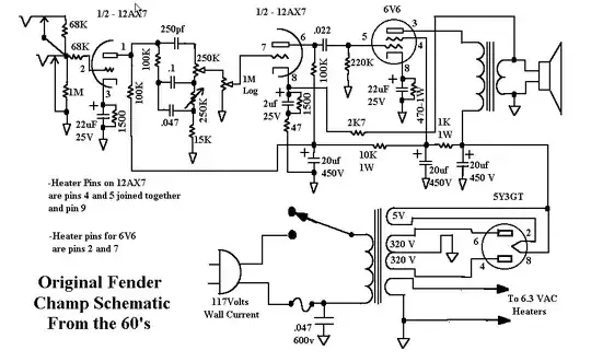

The normal rating for vacuum tube heaters is 6.3 volts and 12.6 volts. The 12.6 heaters normally give an option for a centre tap so they can be connected as two 6.3V.
There was always a debate about which was best A.C or D.C. but the original amplifiers were wired as A.C.
The perceived benefit of rectifying was to reduce hum but the rectified power still contained a large AC component at 100/120 Hz.
