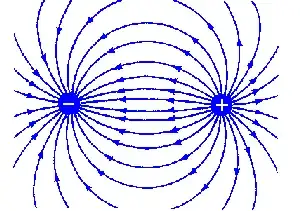

Say you have an electron (negative charge) and a proton (positive charge). Naturally, these two will attract, and (so far as I understand it; I'm not a physicist!) this is what keeps electrons stuck to their atomic nuclei.
But, if you can pull these two apart, you get a field between them. You might visualize it like this:
(image source)
These lines represent the force (in our case, the electromotive force) that would be experienced by a charge, were it to be in this field. That is, if you were an infinitesimally small charge in that picture, you would be feel a force pushing you in the direction of the arrows. You can think of the proton as spewing out an invisible fluid, and the electron sucking it in. This invisible fluid acts on other charges like wind.

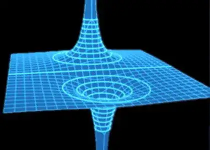

Here's another way to visualize the same field. The proton is a mountain, and the electron is a valley:
3d field
(image source)
If you are a ball on this field, gravity will do work on you, and you will roll downhill. Except, this isn't a gravity field, so our "ball" is made of "charge", not mass. Of course, if you add any charge to this picture, the field changes. This is also true of gravity fields, except the Earth is so much more massive than the ball you imagine that its effect is negligible. So, imagine that your ball of charge rolling around in this field is infinitesimal.
Now one thing you will notice about this field: as we extend it out to infinity, it becomes flat. The electric field potential at this infinitely distant place is \$0V\$, by definition.
If we want to put a ball on the mountain from infinitely far away, we will have to do work. How much? Well, it depends on two things: how high we want to push it, and how big the ball is. A big ball takes more work. Pushing it higher takes more work.
One way to define the volt is joules (energy, work) per coulomb (charge):
$$ V = \frac{J}{C} $$
So you can think of it this way: if you had a ball of charge that was 1 coulomb big, and you did 1 joule of work pushing it uphill, you are one volt high. Or, if you have a 1 coulomb ball of charge, and you let it roll downhill into the electron, and stop it after 1 joule of work has been done, you are at -1 volt. If your ball was 2 coulombs big, then the work is doubled, but it's still just 1 volt.
Thus, you can pick any point in this field, and get its electric potential. It's how much work could be done, or has been done, per unit of charge, getting to there from infinitely far away. With our hill and valley analogy, electric potential is analogous to the elevation.
When you stick your probes on two points, you are asking the question:
If I let a ball of charge that is 1 coulomb big roll between these points, how many joules of work will be done on it?
Of course, we can't get infinitely far away from all charge in the universe, so we can't actually measure electric field potential directly with a multimeter. We can only measure electric potential difference. But, we can calculate the electric field potential, if we know where the charges in a system are.
